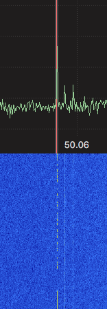

Had a spare half hour so thought I'd get pre-emptive:

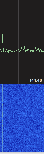

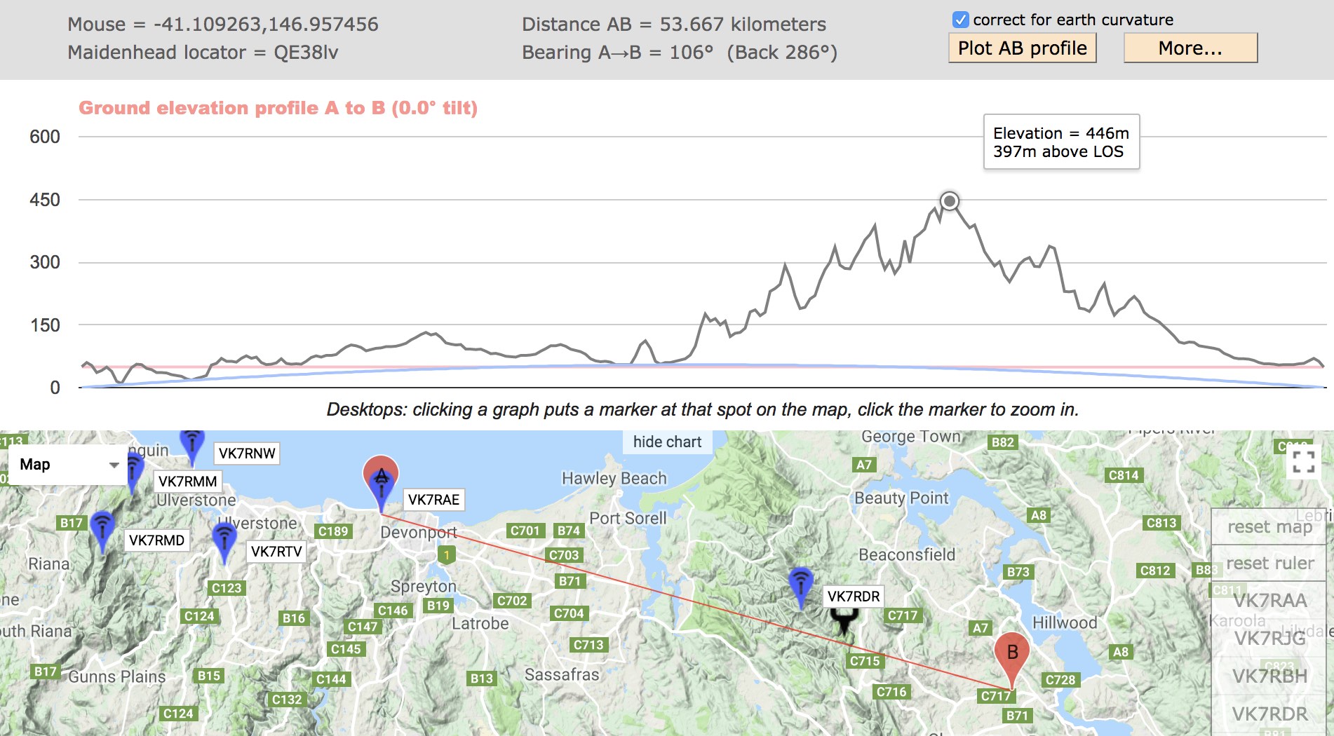

Here is the path from me to our local beacons on 50Mhz, 144MHz and 432MHz.
As you will see the 53 kilometre path is a large rocky hill.
The pink line is the Line of Sight path and is 397 meters below the peak.
The beacons are 25 watts into vertical dipole antennas.
The pics show the signals at my place received on a 160m perimeter triangle wire loop average height 10m above very ordinary ground and among trees, as heard on an SDRPlay RSP1A using Gqrx.
The morse code beacon callsigns are readable in the waterfall. HF loops perform very nicely at higher frequencies.
Darn... this Forum software only seems to permit three attachments at once.
[to be continued]
Phil VK7JJ

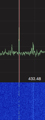

... here is the 432 beacon:

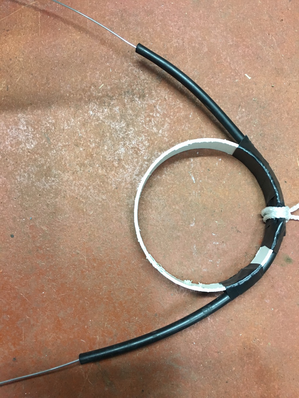

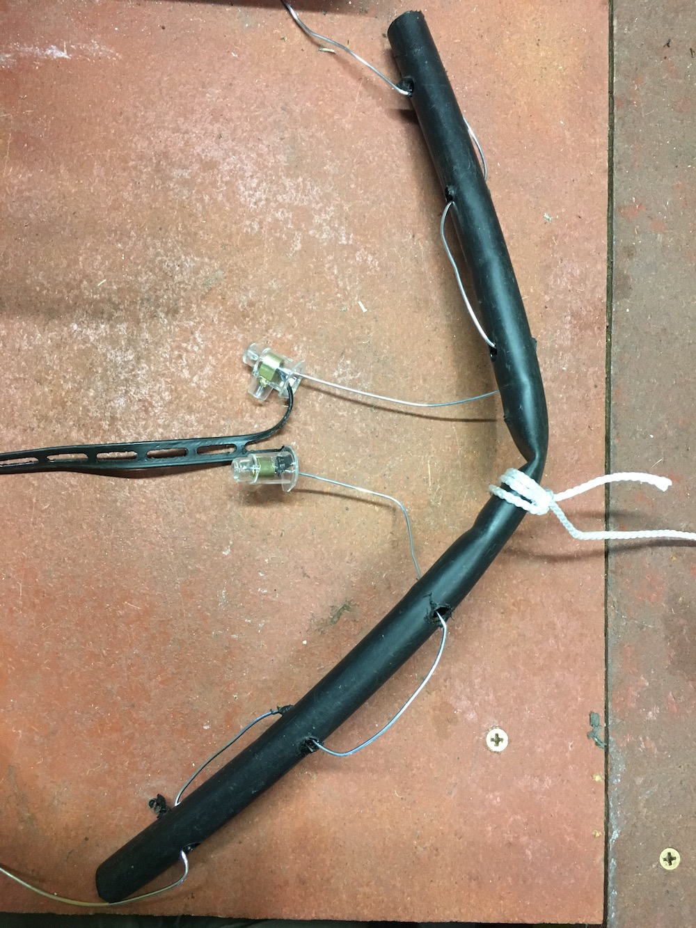

Now for attaching the aluminium wire. I did this specially just for now :-) Timed myself and while I do have that sort of stuff lying around - I also fed the chooks while fetching the black poly. Total time taken was 32 minutes.
Corner:
- uses a slice of 90mm PVC drain pipe to keep the curvature
- feed the wire through a short length of 4mm flexible irrigation poly pipe
- that way, as you tighten the nylon to raise the antenna, the wire slides through and evens itself out.
Mast feed point:
- speaks for itself, uses 12mm irrigation poly pipe
- drill three holes in each side
- thread the aluminium wire through the holes and it's held captive
- fasten the aluminium to the copper with small mains power screw connectors
- if you are worried about corrosion and water there is a special paste just for Al and Cu joins at industry type electrical suppliers
Regards, Phil VK7JJ

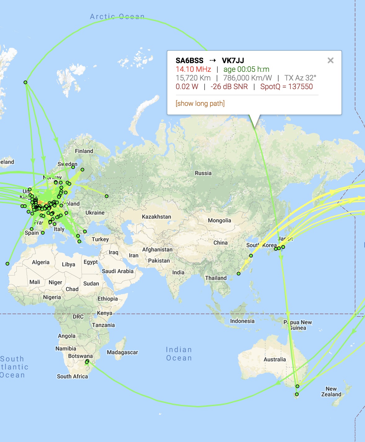

... and they work even better on HF.

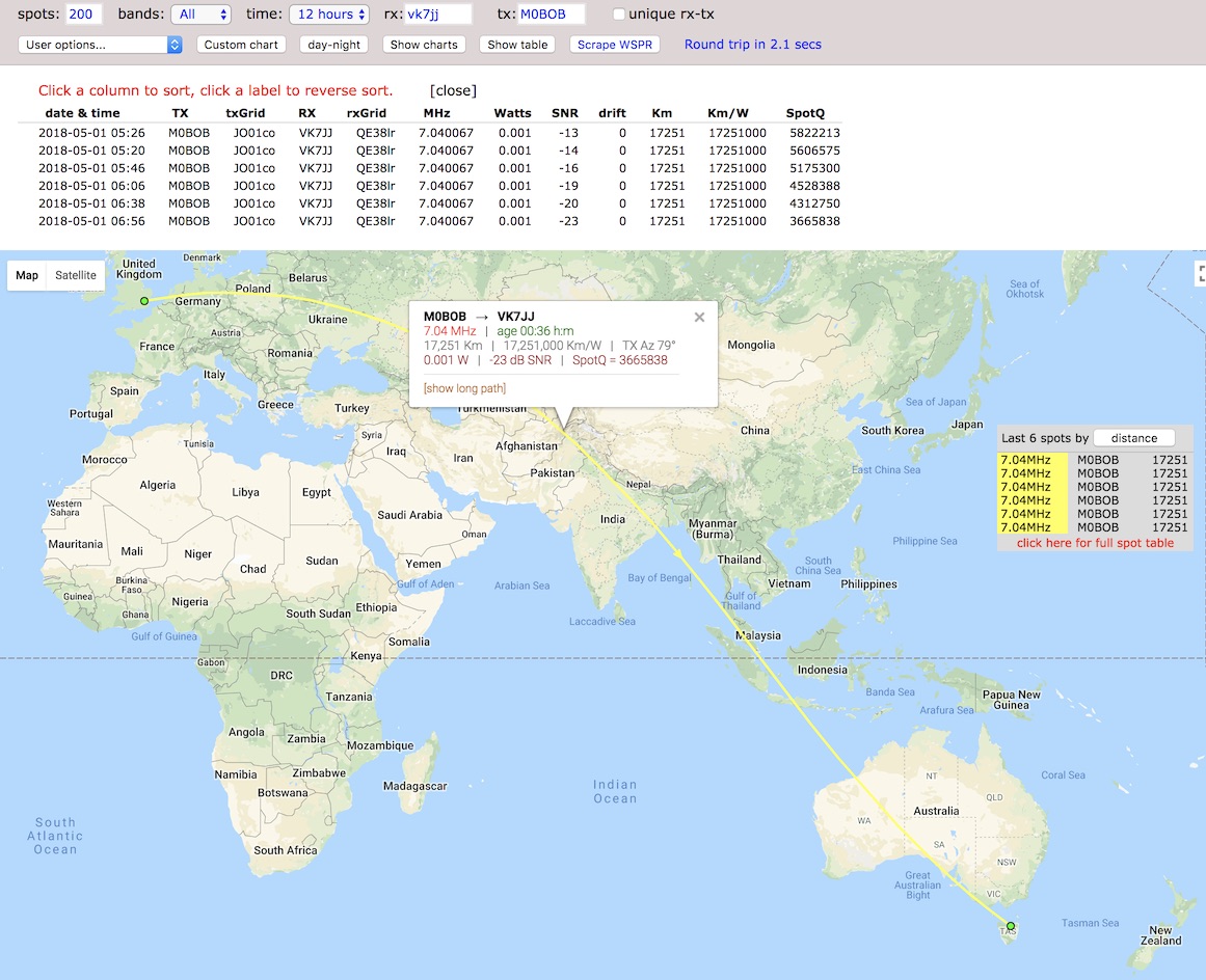

Two WSPR screen dumps. The first is from a ship in the arctic circle to Tasmania transmitting on 7MHz using 0.02 of a watt.
The second is from the UK to Tasmania showing successive contacts again using just 0.001 of a watt on 14MHz.
RSP1A's work very well, as do horizontal loop wire antennas :-)
Regards,
Phil

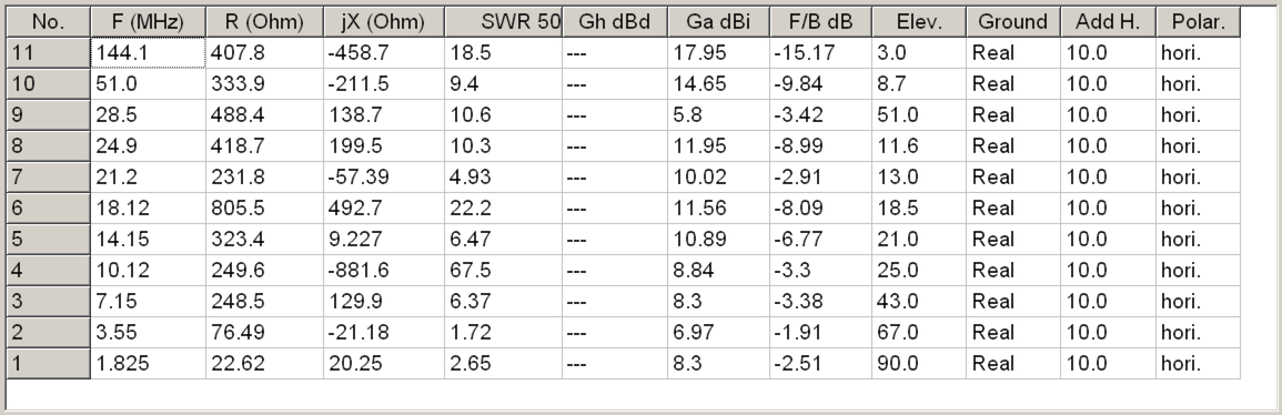

Here are some antenna models created using a free copy of MMANA modelling software which anyone can download and play with.
Models are great for enhancing one's understanding of what's actually going on (their numbers are indicative not definitive), they are also great at exposing key differences between different antennas.
The table of results is for an aluminium wire triangle with 170m perimeter, equal length legs, height of 10m over 'ordinary' quality ground.
It's beyond the scope of a post like this to go through all the figures and point out the good and bad bits, most amateurs will be quite familiar with the terms. The major good things to point at in this table are
- pretty good R and SWR figures with no dramatic excursions across the bands
- good gain, yet an omnidirectional pattern, eg. compare with 6 el Yagi above 30m: http://yagi-uda.com/six_elements_yagi-uda.php
- excellent angle of radiation (the Elev. column), especially given the low height above ground
- horizontal polarisation means less susceptibility to man made noise
- it's a loop with balanced feed point: a really important feature for reducing noise. This can be an issue of hot debate and I'm willing to hotly debate it :-)

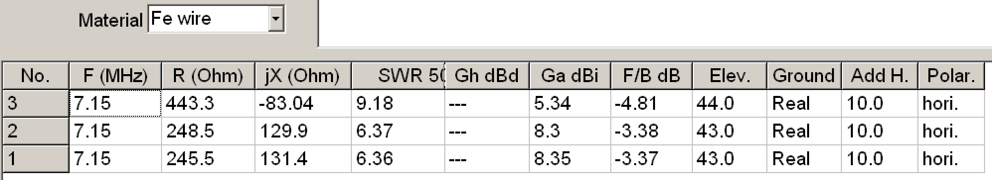

Aluminium v Copper
Many people will worry about the resistive losses of aluminium compared with copper. MMANA provides a pop-down menu with a choice of metals. The table below shows the R (Ohm) figures for copper at the bottom, aluminium at the middle and iron/stainless steel at the top. Clearly, aluminium's slightly higher resistive loss makes negligible difference to the gain. The big lesson is DON'T use stainless steel!

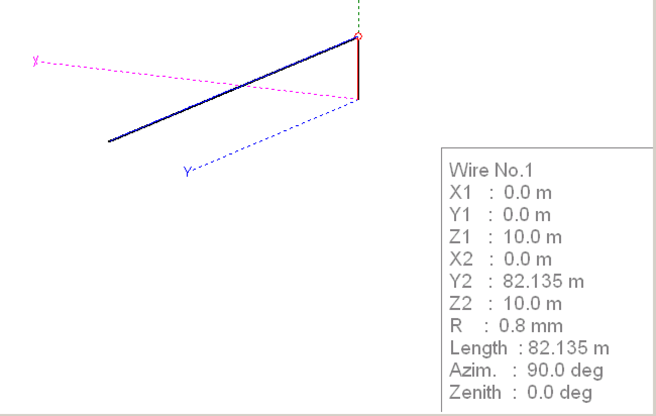

The model assumes a 10m high metal mast with an attached wire that is one half wave long at 1.8Mhz
In the case of a non-metal mast the coax braid takes it's place electrically speaking.
Here it is for visualisation:

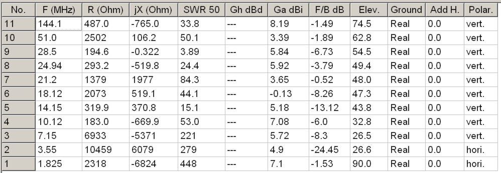

Here is the table for comparison with the loop:
- there are large excursions of R and SWR across the bands
- the gain is not as good
- the Elev. figures show the angles of radiation are poor; the lowest 3 bands might look OK but the SWR is too bad
- it is vertically polarised, which may surprise a few people, meaning poorer immunity to man made noise
- it is an unbalanced antenna effectively driven against ground and prone to all the nasties caused by common mode electrical interference.
Hopefully the modelling exposes some of the key advantages of a loop and helps justify it's selection.
