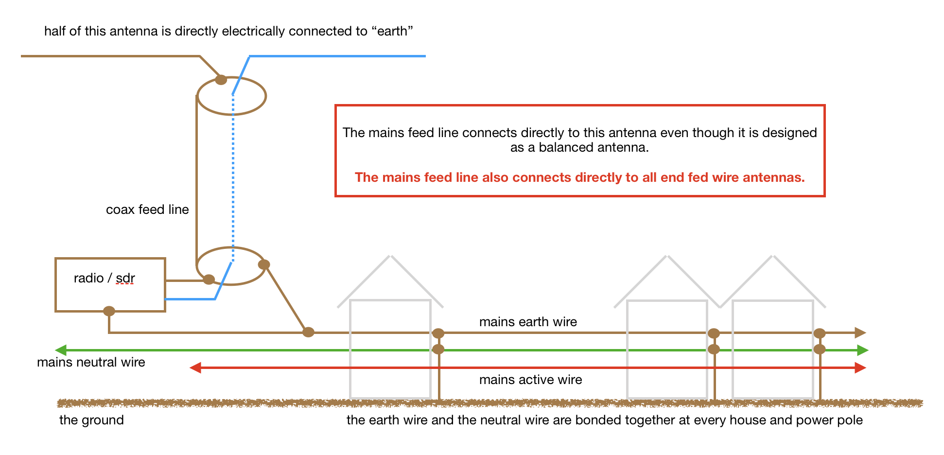

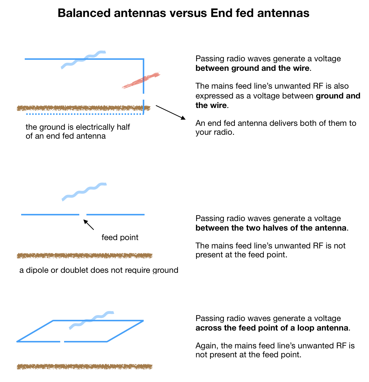

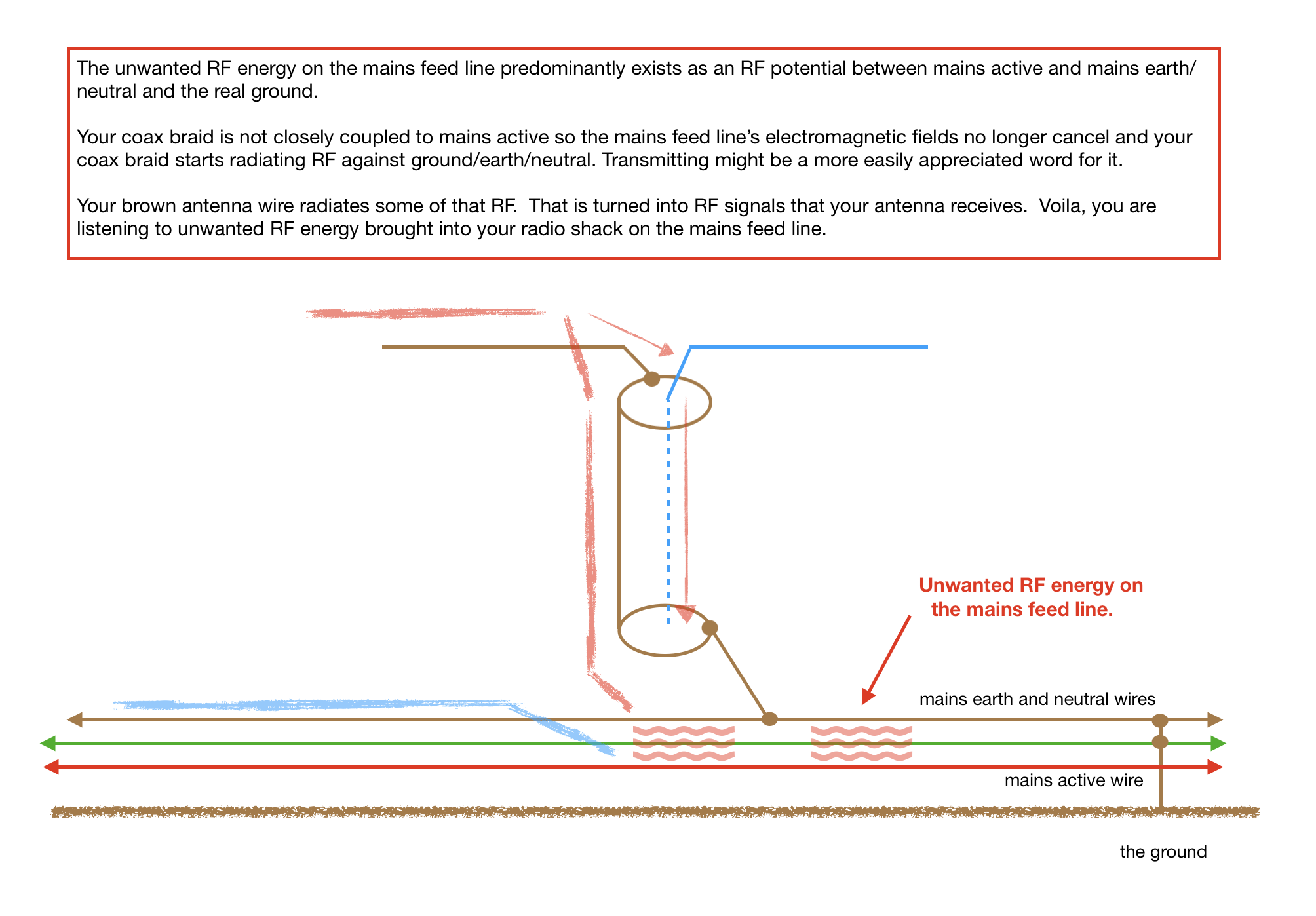

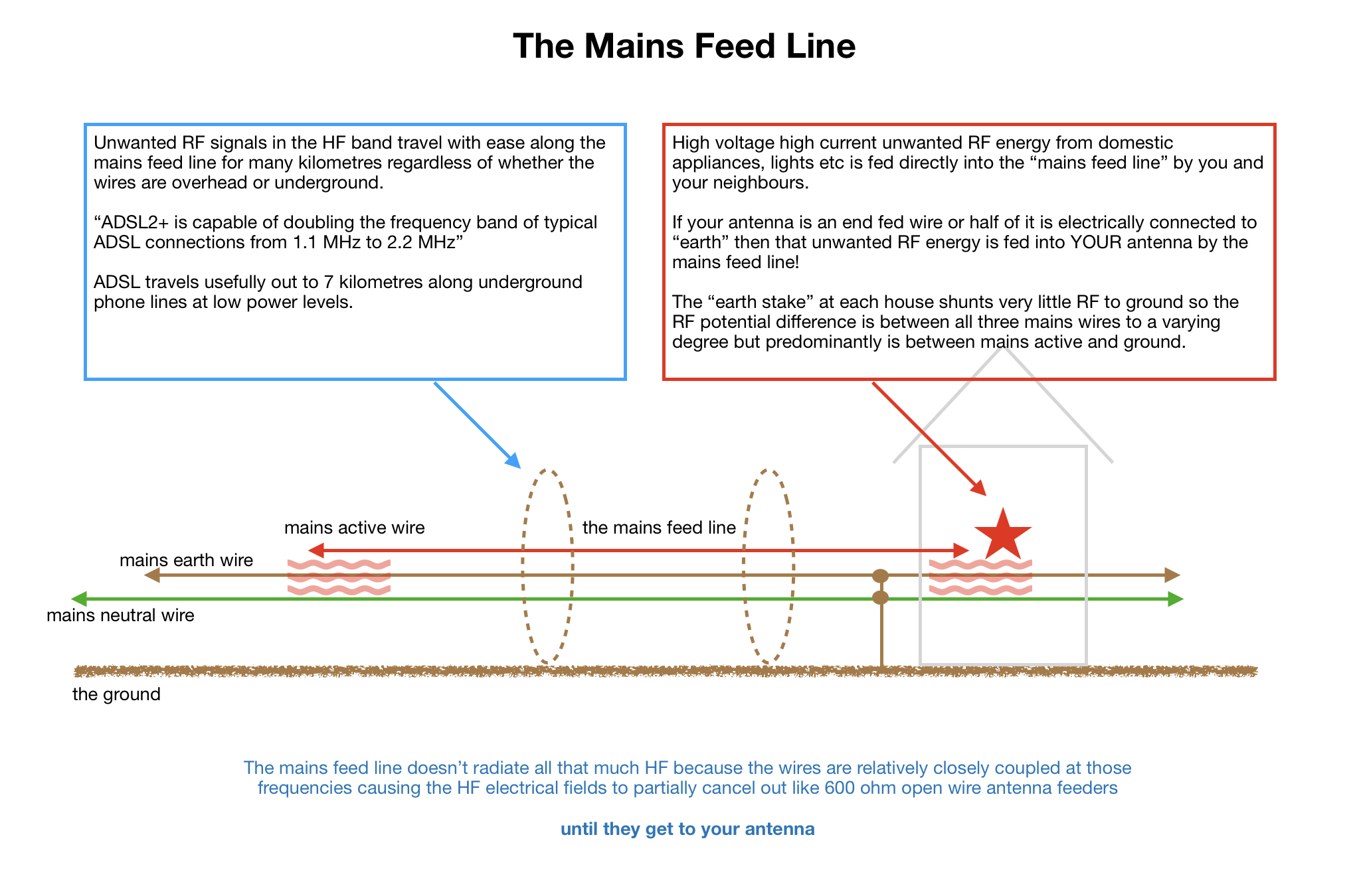

The first step is to appreciate the principle of "the mains feed line" so here goes with that. This post is an attempt to provide a really simple picture of what is happening to me. The second part - what to do about it - is also pretty simple.
If this post generates any interest I'll have a go at what I did about it but before that I'd appreciate the thoughts of others.

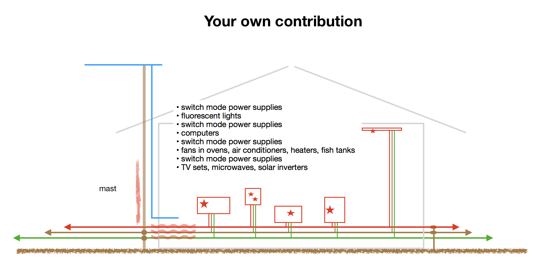

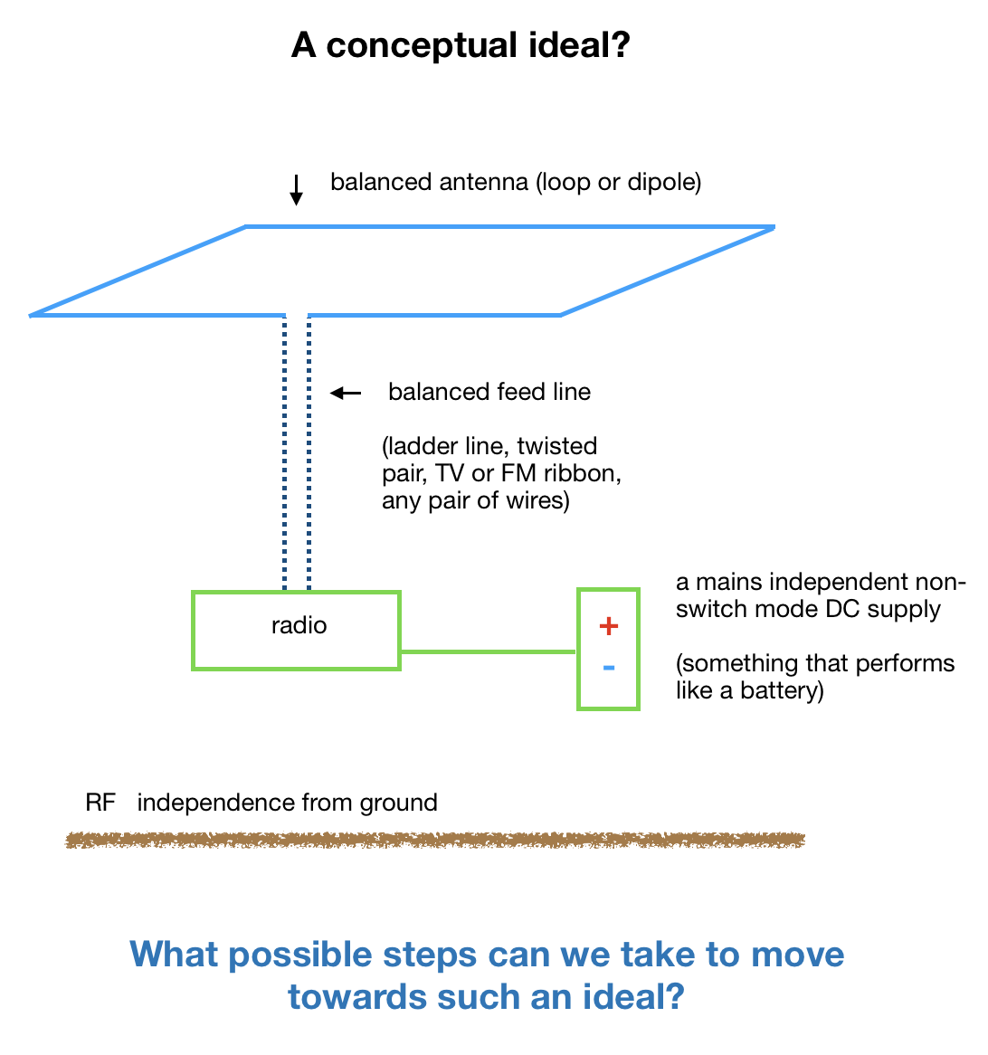

Hi guys and thanks for the comments! Instalment number two of this breathtaking thread is at hand.
We can't look towards "what we can do about it" until we sus out more of the problems and then visualise a possible goal we might work towards. So here goes with that.
We are our own worst enemies because we send lots of electrical crap into the mains feed line.
Antennas provide the greatest single opportunity for us to have fun with our receivers and improve our signals.
Your little SDRPlay black box can only deliver to you what you put into it!
PS. No brownie points will be awarded for finding the mains short circuit. There was also a technical error in the first post, thank you all for not pointing it out and totally embarrassing me.
