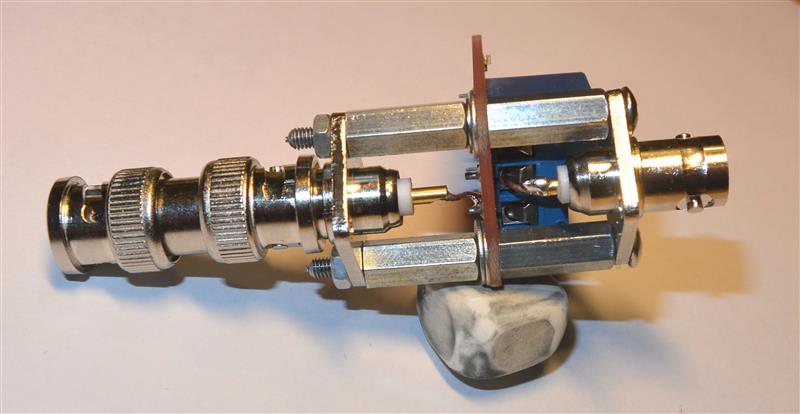

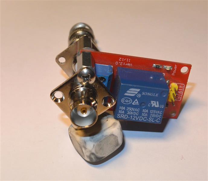

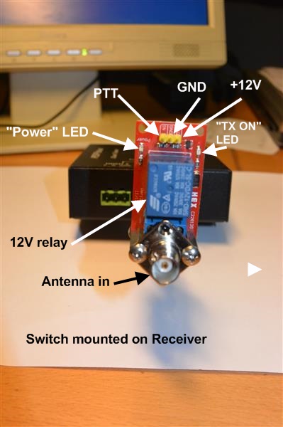

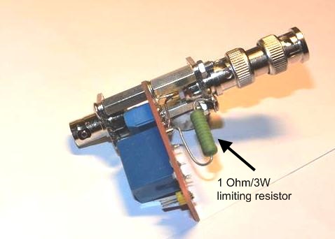

Switch 3.JPG (57.3 KiB) Viewed 112561 times
Switch 2.JPG (75.83 KiB) Viewed 112561 times

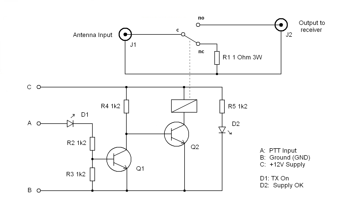

Thank you to Glovisol for his excellent and elegant circuit. As he says in his text there is a way to protect the receiver in case of failure of the 12 volt supply to the circuit. I think my version of his circuit was his intention.
RX Isolator.png (45.28 KiB) Viewed 112505 times
Consider the modifications of his circuit as shown above.
First state: The power is off so the antenna is switched to R1 via the normally closed (nc) contact. RX safe.
Second state: The power is on. As in the original circuit, Q1 is held off by R3. Q2 on the other hand is held on by R4 so the antenna is now switched to the receiver via the normally open (no) contact of the relay. RX in operation.
Third state: With a positive voltage (PTT) applied to "A", Q1 is now turned on by the current through R2. This in turn pulls the base of Q2 very close to ground turning it off and in turn turning off the relay. Once again, the antenna is switched to R1 via the normally closed (nc) contact. RX safe.
Lou

Yes I see that now. In that case, as long as the PTT (SEND) line can sink at least 10mA it can connect directly to the base of Q2. Then, remove D1, R2, R3 and Q1.
Thanks for the feedback.

Hi Lou, excellent diagram which fills the bill for a failsafe antenna switch. I would only add 0.01 to 0.1 uF (not critical) bypass capacitors across the 12 V power supply input and between base and emitter of Q1 and Q2 to avoid malfunction due to excess RF rectification.
I would also add another 0.1 uF capacitor across the relay windings, in parallel with a reverse diode, to protect Q2 from inductive kicks. With negative going PTT, LED D1 should be placed in series with the base of Q2 with cathode connected to a limiting resistor. Finally, just to be safe, Q2 should be a TIP31 with a series diode in the emitter lead (1N4001) to offset the forward voltage of D1. Considering your much "cleaner" and clearer schematic, you should incorporate these refinements in your drawing and post it.
And yes, Roger, you are right: with ground going PTT, Q1 and related components are no longer necessary and can be eliminated, adding to reliability.

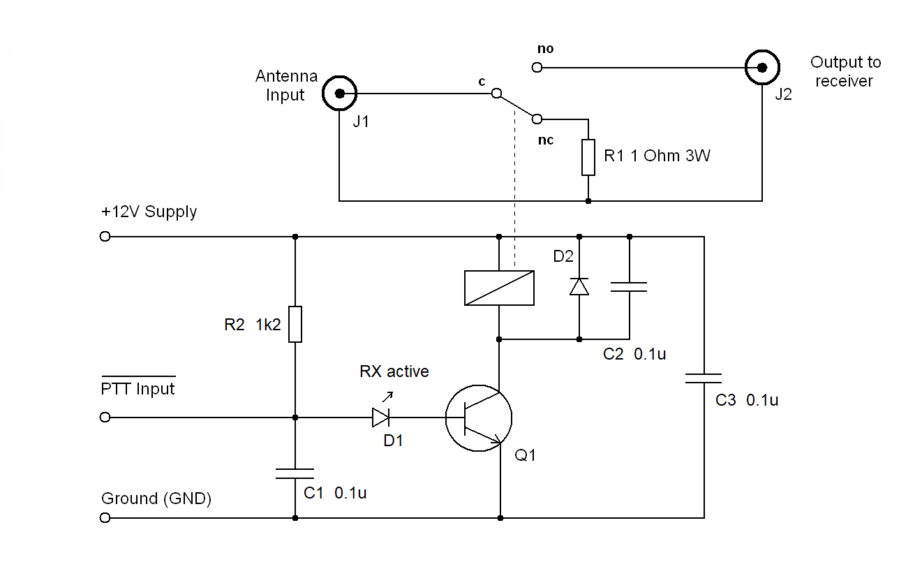

Thanks for the comments and suggestions. It shows that even in a simple circuit there may be room for improvement. Here then is the revised circuit with bypass caps and back EMF diode across the relay coil. I was lazy this morning and left them out. Not surprised that I was caught. :)
RX isolator 2.png (48.44 KiB) Viewed 112390 times
A much simpler circuit than before, but essentially the same behavior.
With no power the RX is safe.
With power applied RX is now in operation and the LED warns us that the relay is active.
With the PTT line pulled low, LED and relay are off and the RX is protected.
