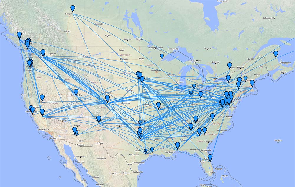

In addition to WSPR, it seems as though there's a certain amount of JT9 traffic, more so on 630m but also 2200m. Here's a map of spots from PSK Reporter:
