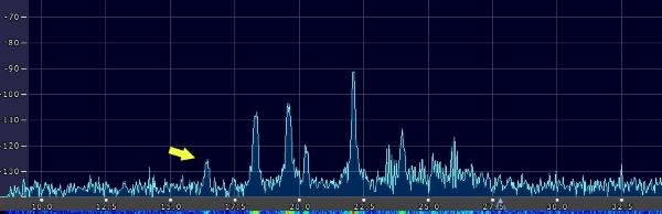

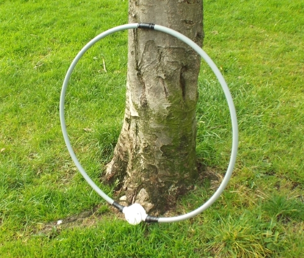

Hi Adam. I had exactly the same problem years ago but a Wellbrook 1530 loop saved my hobby. The noise with outdoor wire antennas had grown over the years and was reaching S9, blocking all but the strongest signals. I tried a remotely-mounted E-field 'probe', but it was just as bad as the wires. So out came my chequebook and a Wellbrook was here within days. Even in the shack it provided several S-points of noise reduction, and mounted outside at gutter height it got the noise down to an indicated S1.
It works well from about 30 KHz to 30 MHz.
As I have an interest in even lower frequencies, I built an 'almost copy' of the Wellbrook using a 3 ft plastic hula hoop and a plastic electrical conduit junction box. 5 turns of wire inside the hoop with the ends feeding my own version of the simple PA1M balanced amplifier. To ensure a good LF response (below 50 kHz) I used a 73 mix ferrite for the output transformer as the usual 43 type does not work well at LF. I stuck a capacitor acrossthe output to roll off the strong MW signals. This was selected on a 'suck-it-and-see' basis.
This loop can see all the way down to below 16 kHz and can easily receive the SAQ transmissions on 17.2 kHz if you are interested in that kind of thing.

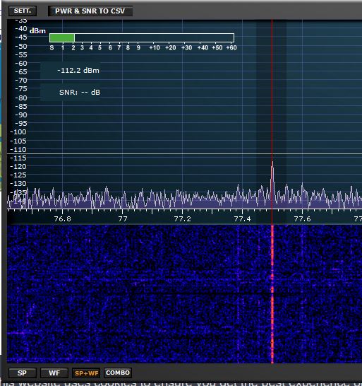

DCF77 (Mianflingrn, GE) 77.5 khz heard this evening in eastern Ohio (US).
Screenshot taken in between thunderstorm crashes south of Atlanta GA (600 miles away)
Received on RSP2, and home built mini-whip with an excellent ground.
