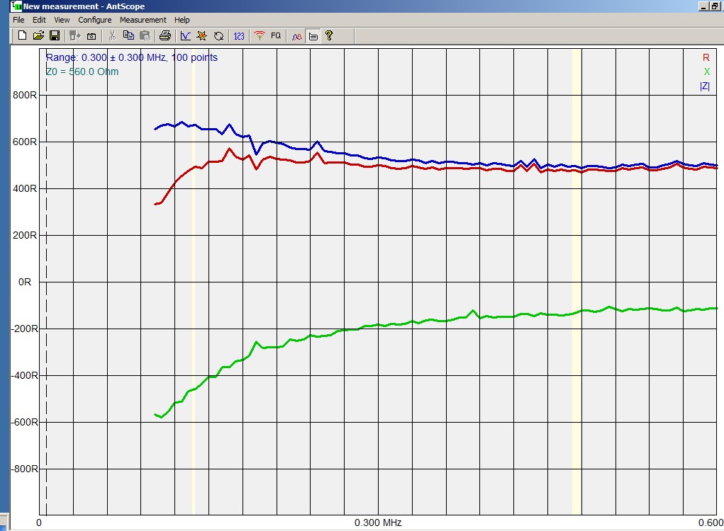

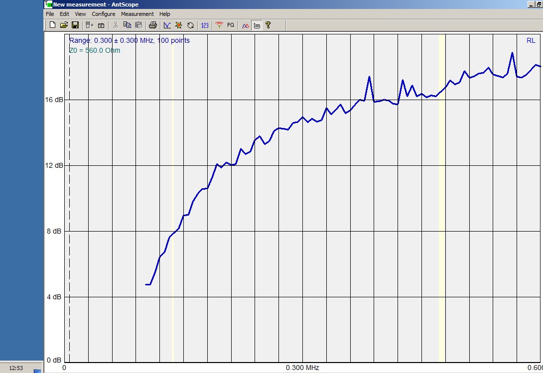

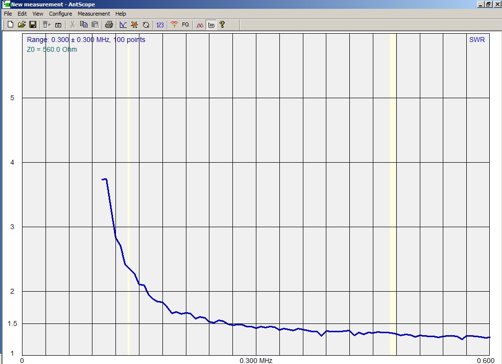

Re: NOISE ADVANTAGE OF LONG WIRE ANTENNA FAR END TERMINATION
At present I am collecting antenna noise data for the next two weeks, in order to compare with previous uploaded data. I have decided to proceed in this fashion, as data collected over only a few days could lead one to wrong conclusions.
In the meantime I have done Network Analyser measurements on the terminated antenna, that show how the Beverage is a true travelling wave, wideband device, covering the entire frequency spectrum from 100 KHz to 29 MHz with fairly constant impedance and quality return loss. Uploaded below results 0-600 KHz.
- 3. TRM 0-600 KHz-Z.jpg (106.82 KiB) Viewed 87359 times
- 2. TRM 0-600 KHz-RL.jpg (87.59 KiB) Viewed 87359 times
- 1. TRM 0-600 KHz-SWR.jpg (80.07 KiB) Viewed 87359 times

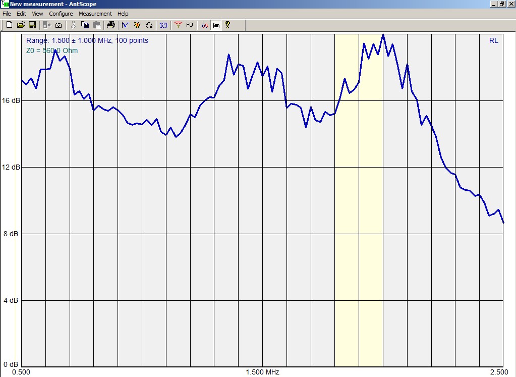

Uploaded below results 500 - 2500 KHz.

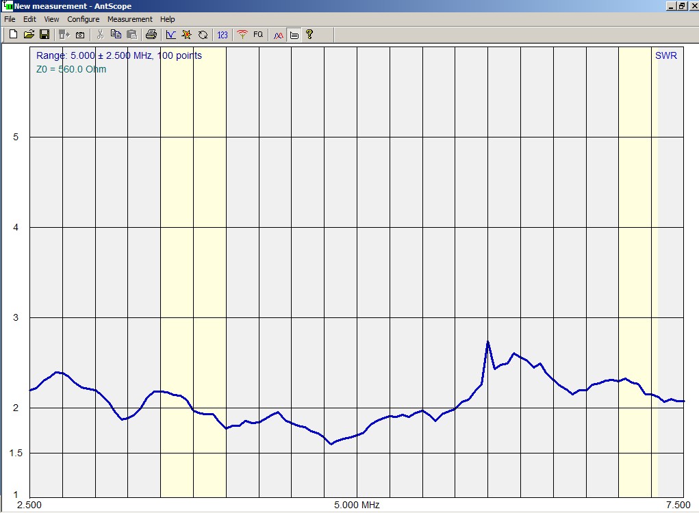

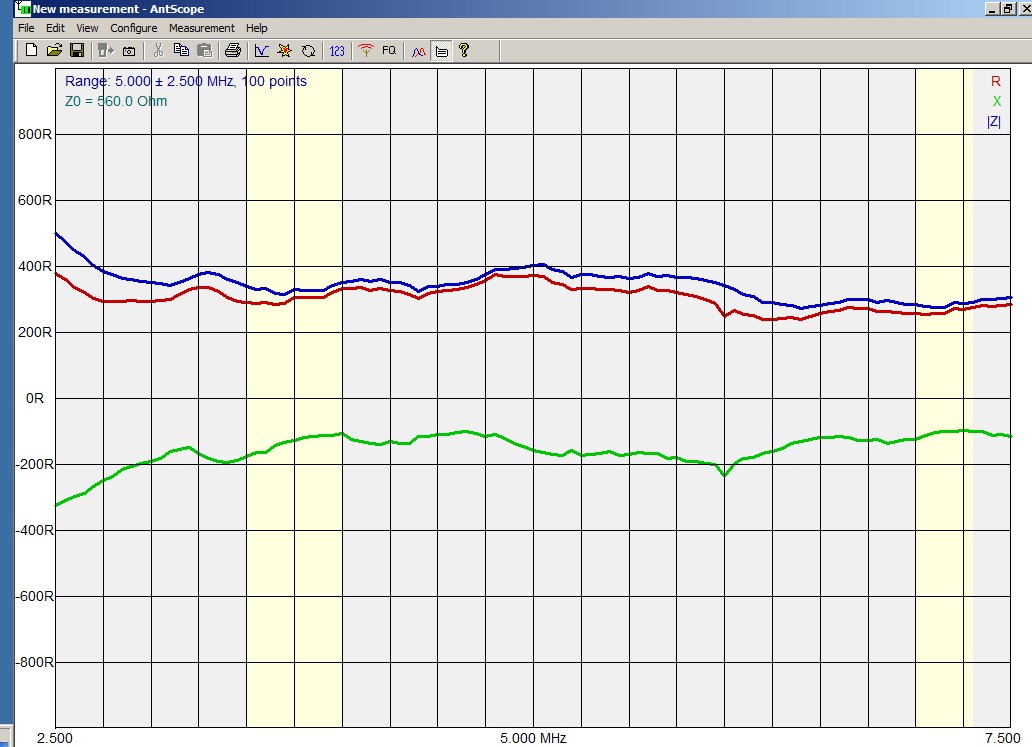

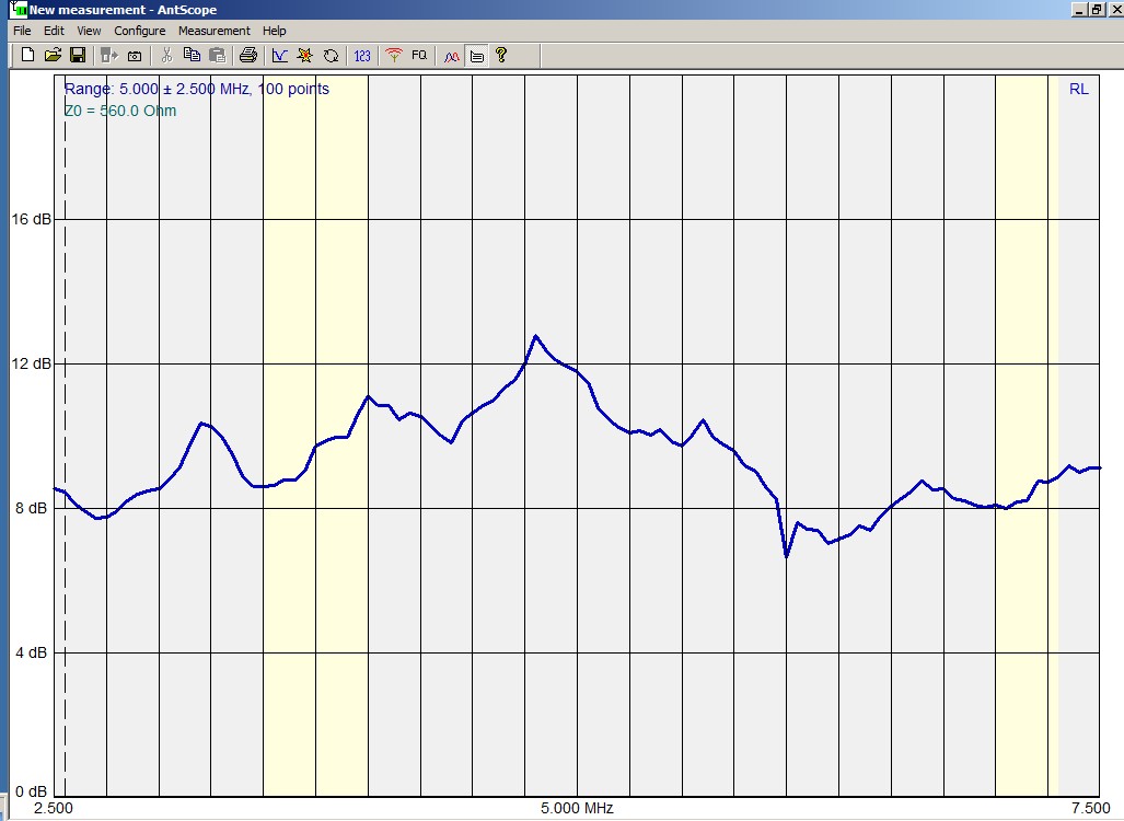

Uploaded below results 2500 - 7500 KHz.
- 9. TRM 2500-7500-Z.jpg (107.21 KiB) Viewed 87263 times
- 8. 2500-7500-RL.jpg (88.08 KiB) Viewed 87263 times
- 7. TRM 2500-7500 -SWR.jpg (83.8 KiB) Viewed 87263 times

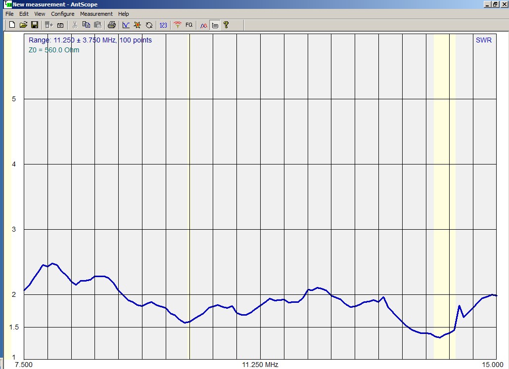

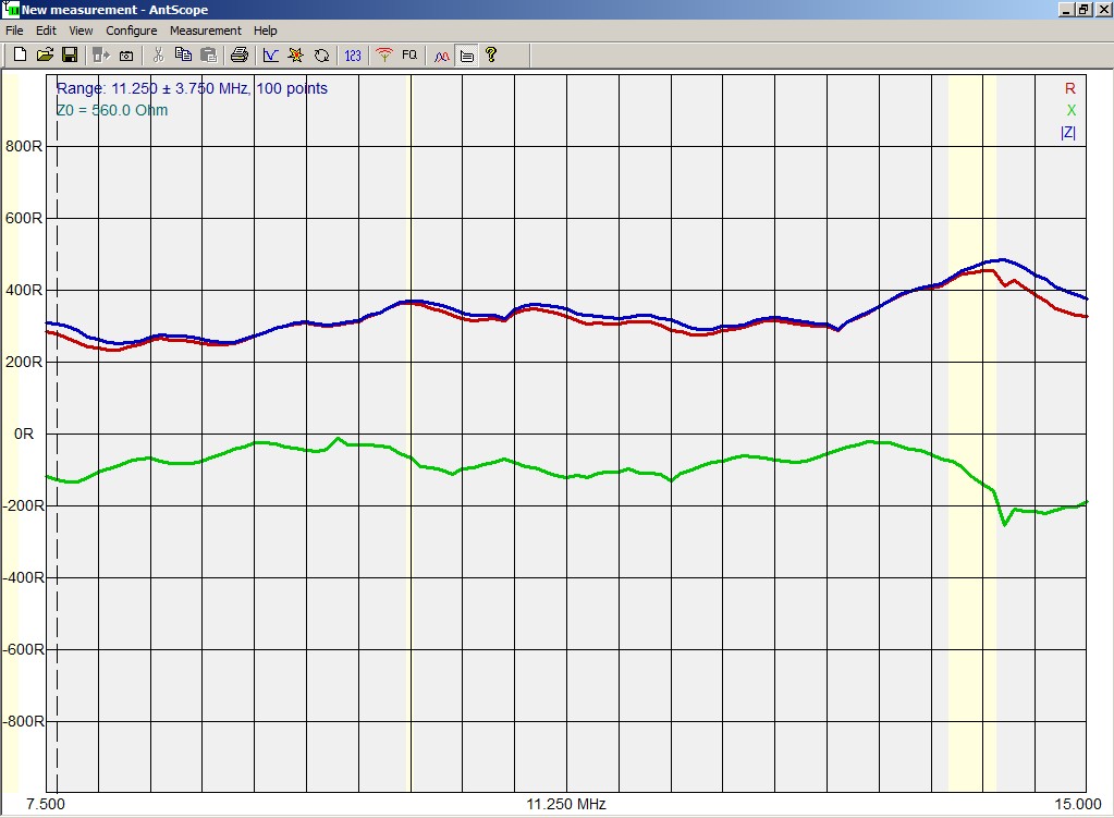

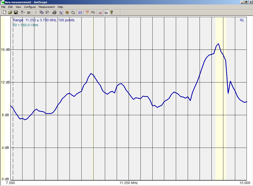

Uploaded below results 7500 - 15000 KHz.
- 12- 7500-15000-Z.jpg (108.79 KiB) Viewed 87175 times
- 11. 7500-15000KHz-RL.jpg (91.99 KiB) Viewed 87175 times
- 10. 7500-15000 KHz-SWR.jpg (85.27 KiB) Viewed 87175 times

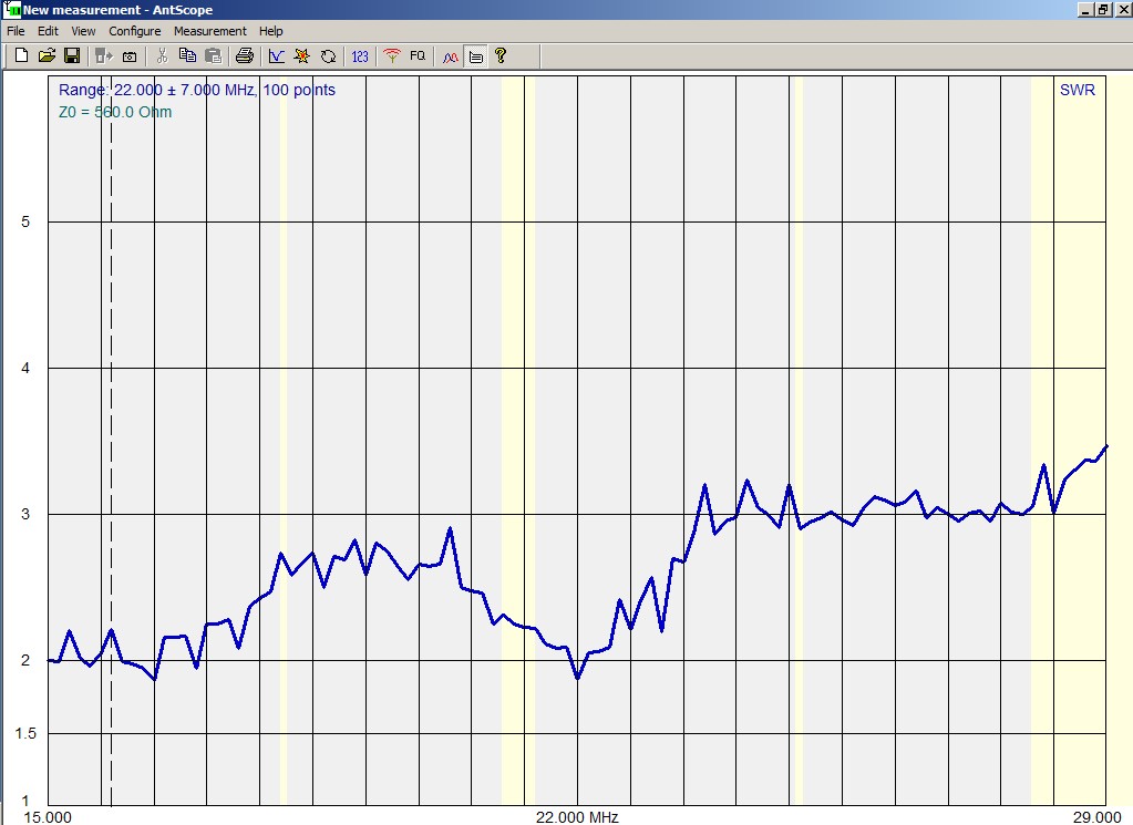

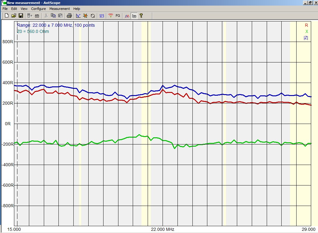

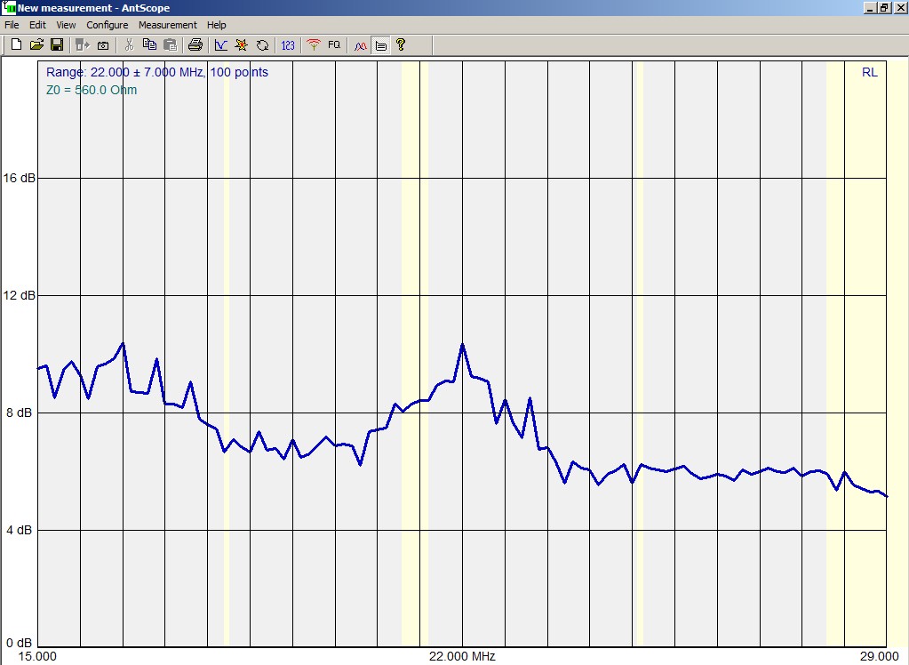

Uploaded below results 15000 - 29000 KHz. Comments and termination optimisation to follow.
- 15. 15000-29000-Z.jpg (115.73 KiB) Viewed 87175 times
- 14. 15000-29000KHz-RL.jpg (92.78 KiB) Viewed 87175 times
- 13. 15000-29000KHz-SWR.jpg (94.55 KiB) Viewed 87175 times

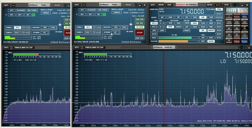

BEVERAGE ANTENNA TERMINATION - 1
Contrary to general opinion, long wire antennas in general and Beverage antennas in particular are not easy to optimise, because their simple form is deceiving. The general optimistic belief is that, once you have the wire to spool out and the land to lay it on, then you have a good antenna, the best for optimal listening work in all of LF and HF range. Here below is a synthesis of the problems one must overcome to reach this end.
The Beverage antenna requires to be laid at a relatively low height on poor and lossy ground. At the two extremities we have the far end, away from the receiver, and the receiver end.The antenna is vertically polarized and because of the earth underneath it has a low radiation angle, ideal for long distance work in HF for wire lengths of one wavelength or more. The antenna has a good directivity out of the far end, provided it is terminated with a resistor of suitable value. Thus the first point requiring attention is the far end termination. The receiver end is connected to the receiver's input and here we meet the biggest difficulties, caused by the antenna return lead.
Somebody like me, with little experience in long wire antennas, in July 2018 planted two ground stakes, 1.8 m in depth (one at the far end, to connect the load resistor and another at the receiver end, to connect the N terminal on the HI Z input of my RSPduo) and happily started using his big "Beverage":
https://www.sdrplay.com/community/viewt ... 2&start=20
In the course of the first few tests it became evident that an isolation transformer was more than necessary and I immediately discovered the vertues of low capacitance ferrite transformers, but my antenna development stopped here. If somebody had come along telling me that with some study and care I could get a worst case received noise improvement of 6 dB (and much more when local noise gets really bad) by looking at the antenna terminations, I would have not believed it. I was so happy with my antenna I even decided to do noise measurements for assessing receiver system performance:
https://www.sdrplay.com/community/viewt ... 6&start=30
It is fortunate that we now have these measurements for comparison to assess the noise/sensitivity variations with the modified and improved antenna.
- Over 6 dB noise advantage with modified antenna terminations on 40 m.
- 7 MHz noise compare.jpg (198.93 KiB) Viewed 86882 times

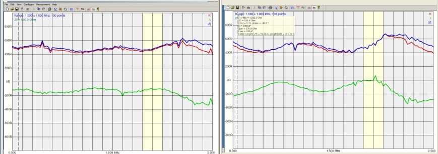

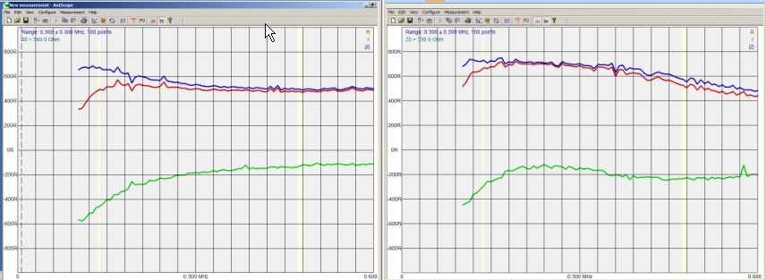

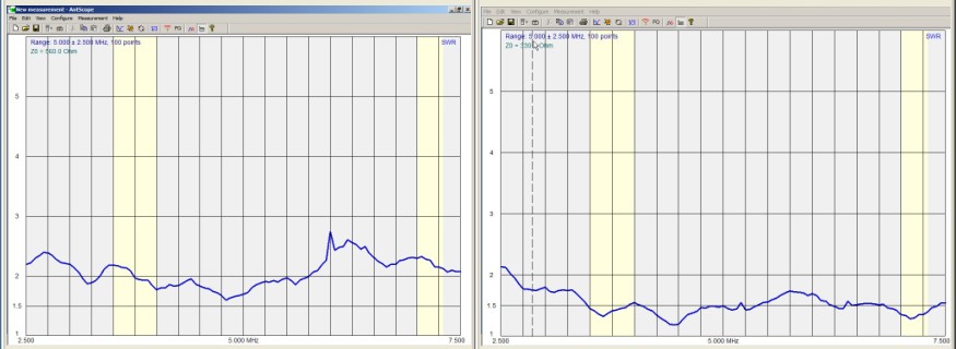

BEVERAGE ANTENNA TERMINATION - 2
- THE FAR END TERMINATING RESISTOR
Theory and software modelling place the impedance of the Beverage antenna at a value between 500 and 600 Ohm, depending on wire altitude over ground and soil characteristics. The previously uploaded test results, done with 560 Ohm at the far end, show that the parallel equivalent resistance is between 300 and 600 Ohm, depending on frequency and that the parallel equivalent capacitance is fairly constant and in the order of 10 to 20 pF. Both resistance and capacitance increase at lower frequencies, where the antenna length to become shorter than one wavelength. The test results show that there is a optimum value of terminating resistor which is the best compromise between the impendance value extremes.
The uploaded screens below and in the following post show what happens changing the terminating resistor from 560 to 390 Ohm: VSWR becomes worse at low frequency and better at 29 MHz, so probably the best compromise for an average antenna height of 6 m above ground is a value around 450 Ohm.
- F. Compare 0-500.jpg (58.37 KiB) Viewed 86815 times
- G. Compare 500-2500.jpg (60.04 KiB) Viewed 86815 times
- H. Compare 2500-7500.jpg (57.36 KiB) Viewed 86815 times

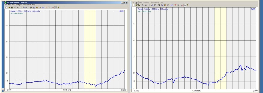

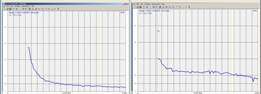

Here below VSWR results compared.
- A. Compare 0-500.jpg (46.91 KiB) Viewed 86814 times
- B. Compare 500-2500.jpg (47.78 KiB) Viewed 86814 times
- C. Compare 2500-7500.jpg (49.54 KiB) Viewed 86814 times
