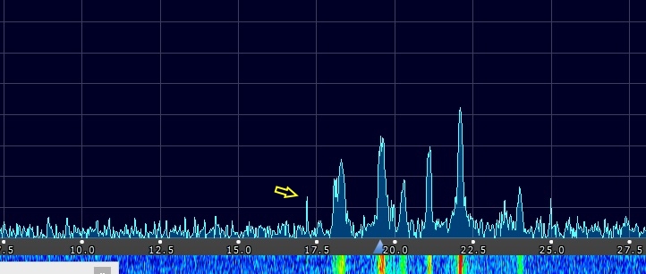

For most of my LW/MW and HF listening I use a Wellbrook 1530 loop to help keep the noise down, as wires are very noisy in an urban environment. However, the 1530 falls off below 30 kHz and only just receives SAQ, so I built a similar loop using a plastic hula hoop with a few turns of wire inside and a simple amplifier similar to the PA1m design. I put a large capacitor across the loop to limit its response to below 100 kHz. Result! SAQ is now easy.
Grimeton May 2018.jpg (100.68 KiB) Viewed 100103 times

Post by g1hbe » Sun Jun 30, 2019 9:44 am
Here is SAQ as received on the loop this morning with my RSP-2. Lots of electrical spikes today, but copy is still good.
