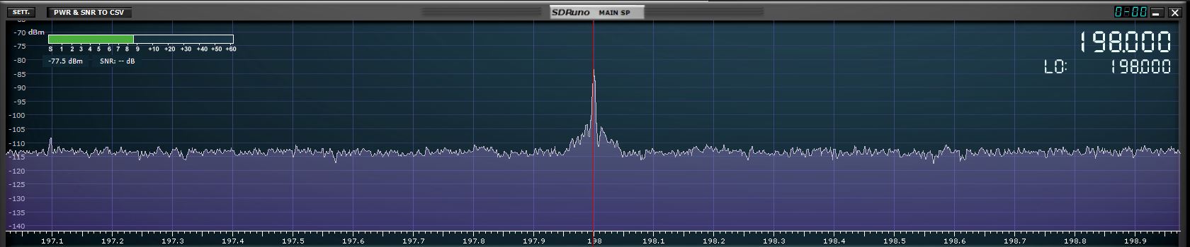

- BBC London.JPG (93.05 KiB) Viewed 120451 times

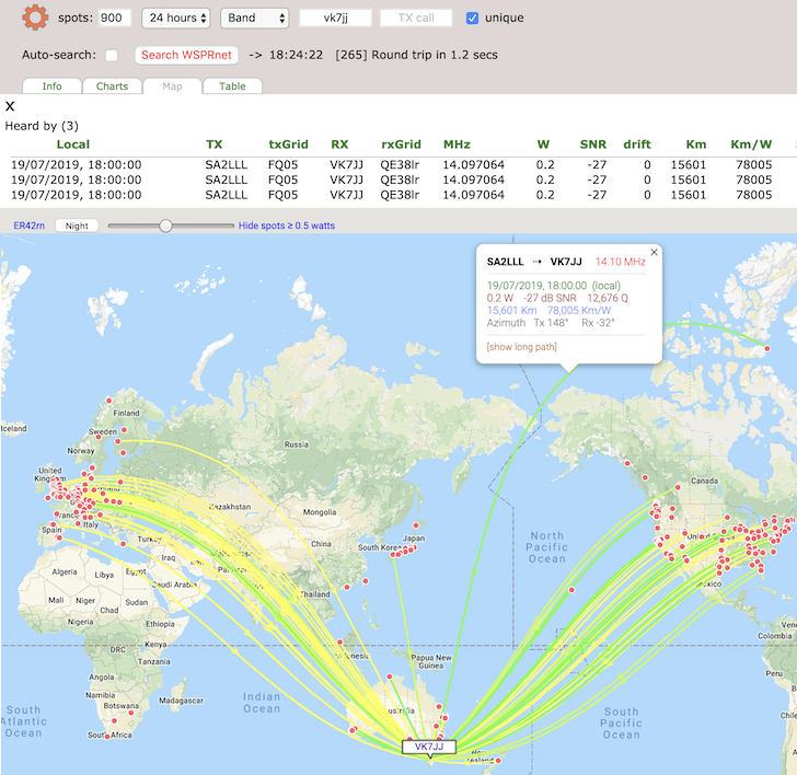

That's good work and deserves commending.
Here's what a large wide bandwidth loop can do; all the paths shown are for stations transmitting at 200 milliwatts or less and all were received in the last 24 hours.
Three receivers were running at once all connected to the one antenna.
The green 20m paths are stations received using an RSP1A. The amateur balloon in the Arctic was obviously up high enough to make the distance. Yellow is 40m and light green is 30m.
Phil

You are certainly getting excellent WSPR reception.vk7jj wrote:That's good work and deserves commending.
Bill

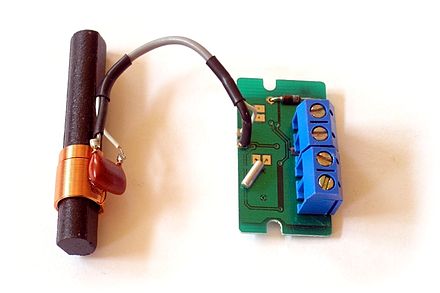

Why doesn't DCF 77 use a miniwhip? What antennas does DCF 77 use?
If you made a whip just a bit longer than a miniwhip it would pick up a bit more of DCF 77's signal would it not?
And if you made it a bit longer still it would pick up a bit more, and so on. Antennas are so easy to make and so much fun they are the perfect complement for SDRplay products.
As an example of homebrewing an antenna for DCF 77 its Wikipedia page offers a suggestion
Don't get me wrong, if a miniwhip makes you happy then fine but it's another thing altogether to give people on this forum the idea that they have to go out and spend money on such a thing is not based on fact, they don't.
That is my motivation, to not just talk about this antenna or that because that never works out, people are too emotionally invested, so I'm trying to demonstrate beyond any doubt that with inexpensive wires and a bit of leg up, people who are crying out for antenna solutions on these pages can create something for themselves.
It's actually fun, I commend it to you
Phil

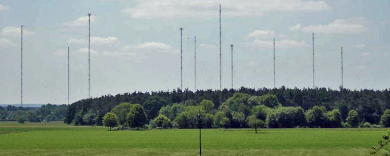

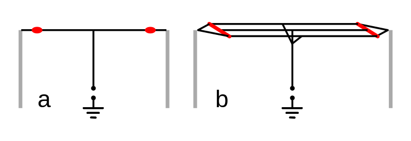

Edit. the photo makes it hard to see the antenna which is said to be a complex T

- 800px-T_antenna.svg-1.png (7.48 KiB) Viewed 120185 times
