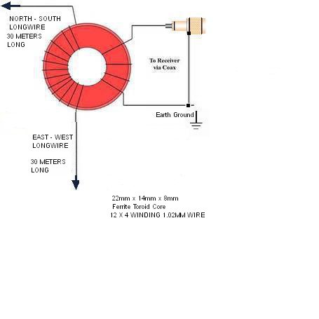

HI to all.
This homemade longwire antenna works great it improved my reception on 80meters to 10meters " 20 OVER " on my sdrplay.
and very inexpensive to construct.
Good Luck
Good Luck

Re: SWL longwire antenna
Hi rgood123, you gave me a good idea to experiment!!!
(My diy balun primary winding has one end connected to the random wire and the other end is grounded to the metal pole -- this is the mostly reported schematic in the net).
Gio
Gio
Thanks rgood123!!! Sometimes simple approach is the best one. I have tried quite a few combinations before - with folded dipole, center fed, simple long wire (single) with 1:1 and 9:1 UnUns - this one comes out the cleanest and stations that i could only sense now come in low but clean. For me it was not 20 fold improvement, but quite significant one - let's just say noise floor dropped from S4 to S1 and strong signals have improved by a few S's. Thanks again and can't wait how far i can get listening.
The "configuration" proposed by rgood123 has a name?
There is some documentation available in internet?
Thanks in advance.
Gio.
Thanks in advance.
Gio.
A dipole antenna with 90 degree radials to each other,I believe is called a Quadrant antenna.
Don't known much about the design.
I can say it works well.
