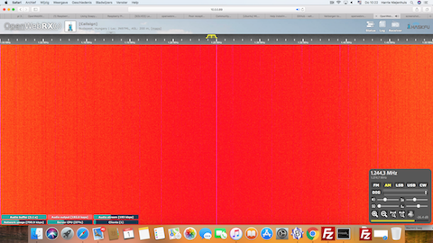

Oké thanks for reply, it seems I have very bad reception at all. When I use my rsp2 local with sdruno or cubic everything is oke.
But in openwerk I have no reception.When I start openwerk everything seems oke:

I see nothing wrong.
Here is my config file:

I see Tuner gain set to 5.00 db. But in config rfgain set to 30?
Schermafbeelding 2018-03-01 om 10.22.24.png (218.15 KiB) Viewed 56059 times
As you can see no reception at all?
