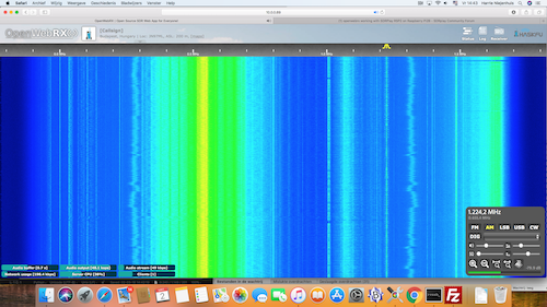

Oke i give up, its the same problem, only big noise. I played around with sample rate, rf_gain centerfrequence and so on, at de best part i only receive some strong stations. Don,t know whats the problem. When i use the rsp2 with sdr uno on my pc everything is perfect. I make a screenshot and as you can see there are big disturbance points. They move by frequence when i chance center frequence.

This is what i see without an antenne:
And this is exactly your config without any changes:
As you see only big noise.Reason: No reason

It would seem to me that what you are seeing on your screen is in fact what your RSP is receiving, surely it can be nothing else, it's nothing to do with configuration, IMHO it can only be RF, and unwanted RF by the look of it.
The fact that you see none of it when the RSP is connected to your PC means that when it's connected to your Pi, there is something different in the physical arrangement. Something in that arrangement is causing RF interference when your Pi is connected to the RSP, the obvious possibilities are
- the Pi itself, i.e all Pi's generate noise but somehow yours could be getting into your feed line or antenna in some way when in use with the RSP
- it's switch-mode power supply (the vertical green bands you see are typical of switch-mode noise)
- the Pi's ethernet connection, i.e. a CAT5 cable spreading noise from the Pi, or, bringing in RF noise from an ethernet switch
- perhaps some earthing complication
- a rearrangement of of your antenna leads or connectors
The first thing I'd do is run the Pi from a NON SWITCH-MODE power supply, i.e. a linear DC supply with an old fashioned transformer and linear regulator, even if you have to go out and buy a 5 V 3 pin regulator chip and build it yourself and connect it to a suitably old fashioned 13.8 volt linear supply. The "buck" power supplies that you see on eBay are switch mode, so don't think that's a way out, it needs to be a regulator like these
https://www.google.com.au/search?client ... 8we9ooOYAQ
Keep working at it, it's receiving!

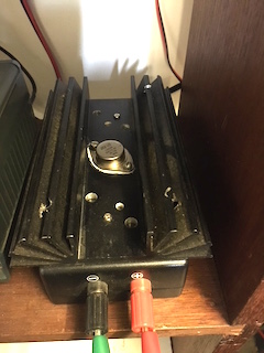

Long ago in the quest to reduce noise I found I had to go linear with my Pi's, I whipped up the very rough box below using a 3 amp LM350 adjustable regulator.

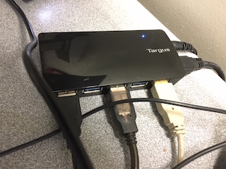

Also use a USB hub powered again from a linear supply, to connect things to the main computer.

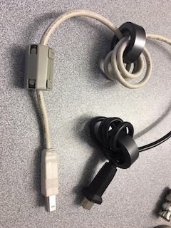

And every USB cable has this sort of treatment even if it comes with a ferrite already. The joy of multiple turns through ferrites is that the impedance presented to any common mode RF on the cable is roughly proportional to the square of the number of turns. Conversely a single pass through a ferrite is paying lip service as it presents only a few ohms impedance at best.
