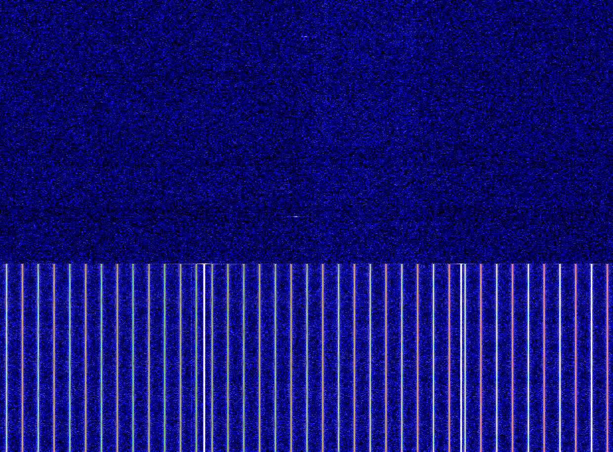

I've got some code, written against the SDRplay API, which searches for intermittent signals caused by reflections from the ionisation trails left by meteors. It does this by running an FFT over IQ samples and then searching the result for a spike caused by such a reflection. This seems to work nicely on my PC, and *nearly* works on a Raspberry Pi too.
In fact it works exactly the same as the PC for a while, but then apparently suffer from severe 'interference' for a while, before switching back to working again, and so on. Each state lasts for a variable period of typically an hour or two.
I do not believe this actually to be interference, though, because although it happens reliably on the RPi, if you wait long enough, I've never seen it on the PC.
Here's an image showing a transition from the 'interference' state back to working (time increases up the page at about 4 pixels/second, frequency to the right at about 2 Hz/pixel). It also shows a couple of real meteor signals.

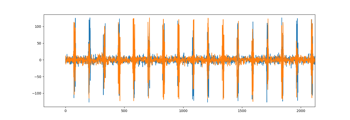

In fact the problem is visible directly in the IQ data passed to the stream callback...
Also suspicious is that the average spacing between noise bursts is 126 samples, which is exactly one quarter of the numSamples=504 samples passed to the stream callback.
This data was taken with no antenna plugged in, so I'm more convinced than ever that this is not real interference, but was generated internally to the RSP or SDRplay API somehow.

Gap=0x3fe15 e=0x501fc a=0x90011
Gap=0xfffefe03 e=0x90209 a=0x8000c
Gap=0xfe02 e=0x80204 a=0x90006
Gap=0xafe0c e=0x901fe a=0x14000a
Gap=0xfff3fdff e=0x140202 a=0x80001
Gap=0xfffcfe0f e=0x801f9 a=0x50008
Gap=0x6fe08 e=0x50200 a=0xc0008
Gap=0x3fe0e e=0xc0200 a=0x10000e
Gap=0xffecfdf3 e=0x100206 a=0xfffcfff9
Gap=0x6fe15 e=0xfffd01f1 a=0x40006
Gap=0xfffefe03 e=0x401fe a=0x30001
Gap=0x1fe0e e=0x301f9 a=0x50007
Gap=0x1fe01 e=0x501ff a=0x70000
Gap=0xfffafe0c e=0x701f8 a=0x20004
Gap=0x9fe0c e=0x201fc a=0xc0008
(etc.)
after a while.
Does this happen for you, too, if you run this example code?
