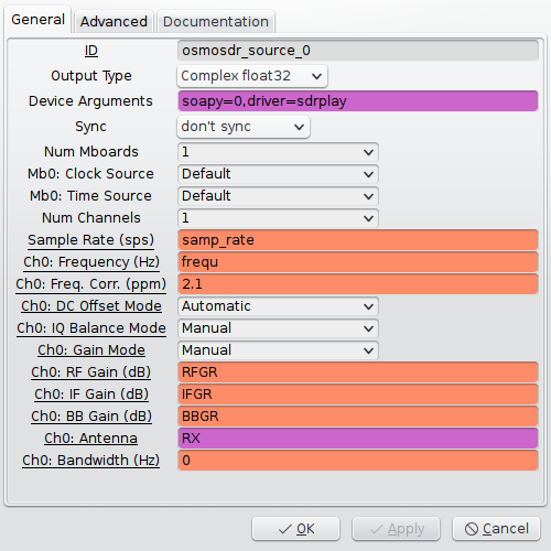

What is your platform? I have the RSP1A running in GRC with Ubuntu 16.04 right now.
It's an old flow graph I built for the RSP1 but it is still working with the RSP1A.
Gnuradio and osmosdr are built from source. I am using the osmocom source with the properties below:
current values:
frequ = 3550000
samp_rate = 250000
RFGR = 34
IFGR = 43
BBGR = 1
