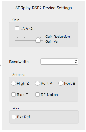

Post by k8-dev » Sat Apr 20, 2019 1:22 pm
Hi Ralph,
New version with RSP2 support: https://www.dropbox.com/s/ned46r5hqnww1 ... 1.zip?dl=0
When an RSP2 is plugged in, and successfully detected, you should see this popup when clicking on Device Settings:-
Screen Shot 2019-04-20 at 14.17.01.png (28.44 KiB) Viewed 89462 times
I don't have an RSP2, so I can't fully test. If you spot issues, please run k8 from the command line and send me the log output - thanks!
Regards,
Matt M0VVC
