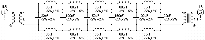

Andy, as you seem to be experienced with external filtering, can you possibly recommend a solution for me:
For listening MW and 160m I have a Double-KAZ antenna, with about 1 kohm impedance, symmetric. It's fed to the RSP2's Hi-Z port by using 12 meters of 450 ohms ladder line.
I'd like to add an external low-pass filter for cutting at let's say 1.9MHz. Preferably by using some off-the-shelf solution. But all the available gear (like Mini-Circuits stuff) seem to be for 50 ohms unbalanced.
Shall I make a chain of 9:1 balun - LPF - 1:9 balun? Sounds hmmm, non-kosher.
73, Jukka oh2bua
73, Jukka oh2bua
Re: RSP2 LO 3rd harmonic spurious response only -20dBC
Jukka - if you want to use off-the-shelf filters, you will need to transform to 50 ohms on the input side and then back up to 1k to feed the RSP. Not ideal. A better solution would be to download an RF package (something like RFSim99) and use it to design your own filter for a 1000 ohm system. All you do is enter the filter type (Chebyshev or Butterworth) HP or LP, roll-off frequency and impedance and press GO. It'll give you a circuit diagram and will also simulate the response for you. Even I can use it!
I've just thought - your system is balanced, so either you'll need to do a balanced filter or transform to unbalanced on the input to the filter (use a 1:1 balun) and back to balanced on the output (another balun).
RFSim is quite old, but it still works, even on my W8 laptop.
Just one more thought re the spurious responses. If you think about a conventional receiver, you don't know about all the unwanted signals until you happen to tune across one. So you tend to think the receiver is virtually free of such things.
When you can see a wide chunk of spectrum, all the nasty stuff is laid out before you and you think the receiver is a sprog box! Good luck with it.

Thanks Andy for your tip for RFSim99.
It's easy to get learned and fun to play with.
73, Jukka
