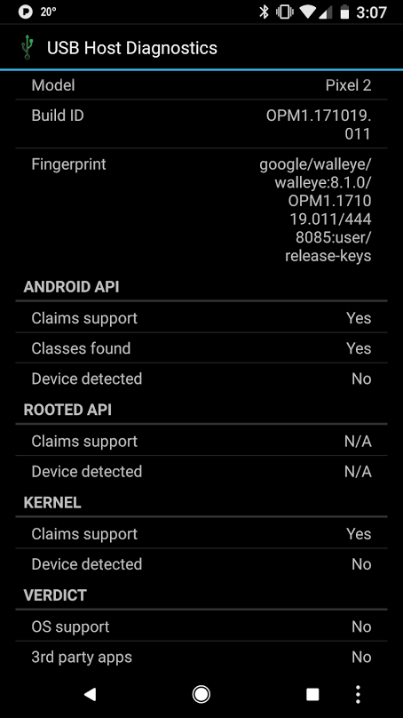

I ran the USB Host Diagnostic tool and it looks like it's not supported.
