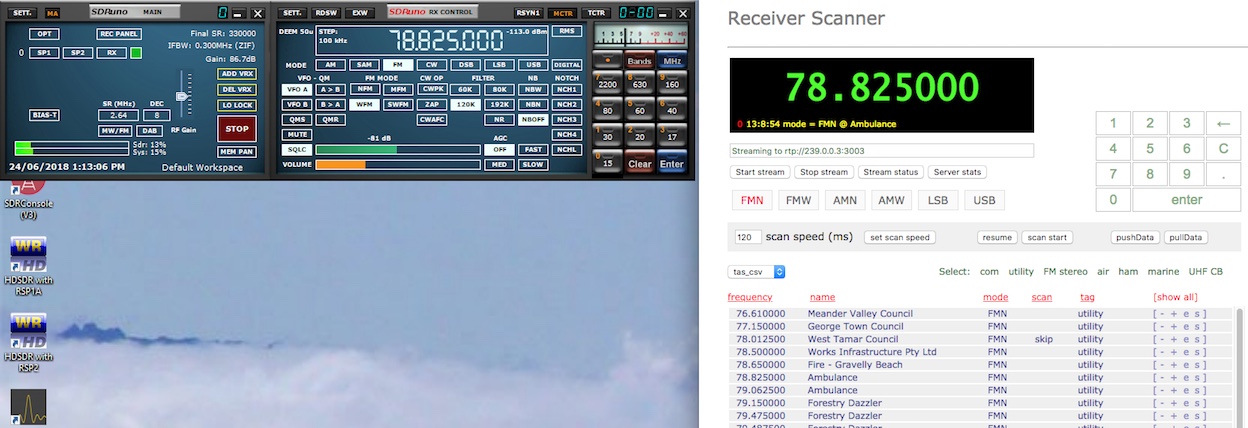

SDRuno so far offers the most promising solution, it runs very nicely with only the MAIN window open, or MAIN + VRX, as per the pic below which is happily scanning across any combination of frequencies at a rate of 120 milliseconds per frequency, and that's on a Windows virtual machine.

The pic shows two overlapping windows with SDRuno running on a remote machine in the radio shack, visible in a VNC window on my Mac inside the house. The scanner software is running in a web browser on the Mac. The Pi is in the radio shack connected to the SDRuno machine via CAT.

I like what you've done there. As you know, SDRuno does respond to BY; but always sends back a "Not Busy" response. Having a status event from the API is something that we are in discussions about. It would certainly help in situations such as this. Once that is available, then implementing BY; as you suggest is something we could certainly do.
