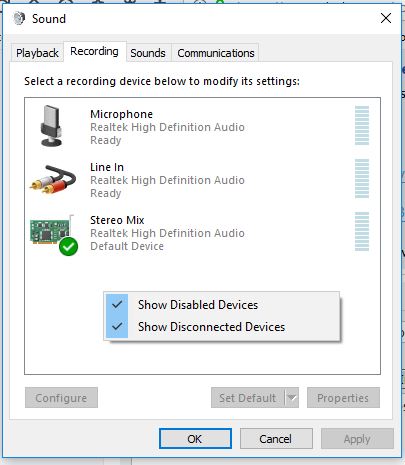

After the update my PC had the default recording device set to microphone. I had set it previously to Stereo Mix.
Rolling back your system shouldn't be necessary. Check your audio playback and record settings first.
To access the Sound control panel:
right click on the Speaker Icon.
Select "Open Sound Settings"
When the sound settings window opens, select Sound Control Panel
Select the Recording tab
Right click in the Recording window and enable "Show disabled devices" and "Show Disconnected Devices". This will show all recording devices installed.
Select the desired recording device and set it as the default - If the device is disabled it will need to be enabled first in the properties window of the device
