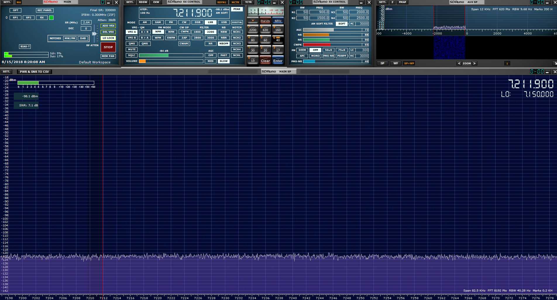

See attachment for picture:
Version -> 1.22.0.0 in Properties. I had downloaded version 1.23.1 I thought I had run the installer but looks like 1.22.0.0 is still operational. So, does that make a difference in what I am seeing?
As far as the S-Meter and dbm meter they seem to be close in the values they show (5.5). I never had a dbm meter before so unsure of the correlation.
The slider in Attenuation mode meters show 5.5 In Max gain mode they show roughly 2.5. From what you are implying the Max Gain setting offers an accurate reading. It does correspond to the S-meter on my FT-450D using the same antenna. If that is the recommended operational mode then no problem with the meter reading relative to background noise. My noise is high here since I am in a condo (shared adjacent unit walls). It is part of the President's Love Thy Neighbor program to promote social cohesion!

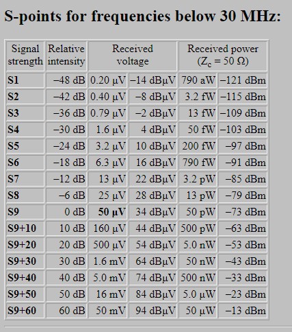

Hi Dick,
Just to clear confusion I am enclosing the table showing the relationship between "S" units and received signal strength (power) in dBm. As far as my experience goes, with the RSP2pro and with the RSPduo, the "S" units shown on the meters correspond to the received dBm with faultless precision even changing the RF gain, provided you do not lower the RF gain to such a point as to bottom the IF automatic gain control.

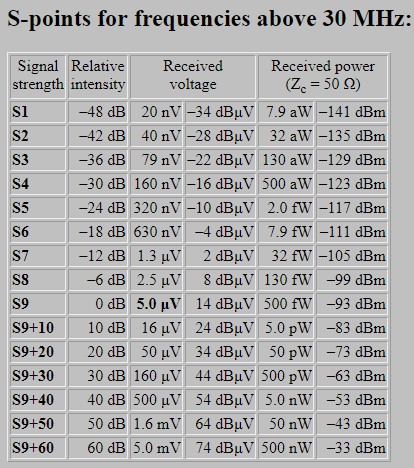

Hi Mark,
Herewith uploaded same table as in previous post, but for frequencies ABOVE 30 MHz....

Hello Mark,
If you look at the above posts from glovisol, he shows that the correct definition of S-meter levels changes as you transition from below 30 MHz to above 30 MHz, with S1 being -121 dBm below 30 MHz and S4 being -123 dBm above 30 MHz. The way SDRuno determines which values to use is by checking the LO frequency (NOT the VFO frequency), so if the LO is set below 30 MHz, it uses one set of tables and if it is above 30 MHz, it uses a different set of tables and that is completely correct to be conformant to IARU region 1 standards.
