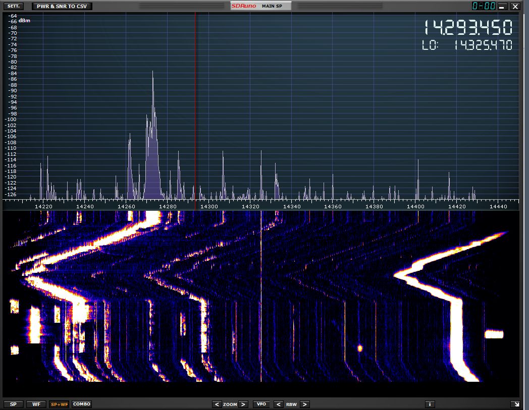

I use SDRuno mainly as a panadaptor for my Kenwood TS-590SG.
When tuning using the radio knob, is there a setting or a way to have the SDRuno scale remain stationary and have the red line move back and forth like a typical analog radio would do? As it is, the line remains stationary and the scale moves, making the waterfall smear across the band. A screenshot is included.

You can use the LO Lock, found in the Main window.

Perfect. Thank you.
