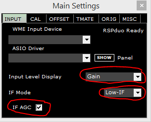

The easiest way to setup SDRuno v 1.24 for best performance is to do the following:
a) Go to SETT in main window
- and select Low IF mode
- and check the IF AGC box so that the IF Gain is automatically adjusted to avoid A/D overload
- and select gain from the dropdown menu so that the slider shows RF gain instead of RF attenuation (like a typical radio)

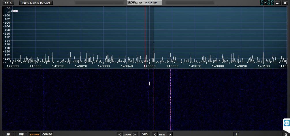

A powerful space surveillance radar in France transmiits 24/7 on 143.050 MHz. I collect the Doppler shifted scatter from meteors illuminated by that radar. I tune to 143.048 to give me positive and negative shifts from that central frequency. I collect data 24/7.
Here is the RX window
SDRUno ScreenShot2.jpg (100.32 KiB) Viewed 36431 times

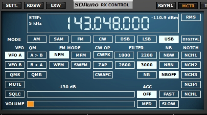

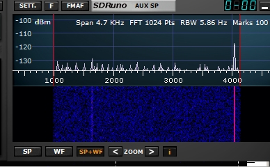

Signals are in a relatively narrow band of +/- 300 Hz of that centre frequency. I offset the USB such that I am detecting in a window in a band band from 1 to 4.1 kHz as shown in the aux SP
SDRUno ScreenShot3.jpg (81.65 KiB) Viewed 36431 times

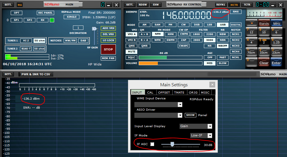

The peak signal near 4kHz is a gps frequency (143.052MHz) and level signal (-75dBm) I inject into the rcx input to provide to calibrate my measurements. (I may change this when I use the duo in two channel mode and phase lock with a GPS) My data collection takes Uno output on a VAC to Spectrum Lab where a script detects signals in a +/- 300Hz band. The calibration is monitored in a seperate band.
Here is a Main SP window showing a meteor signal; this meteor signal varies between -15 and + 40 dB of the clibration level.
SDRUno ScreenShot4.jpg (357.53 KiB) Viewed 36431 times

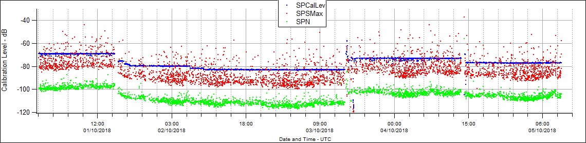

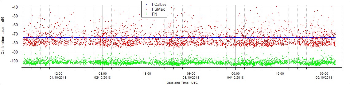

I am going to be away for a week and thought I should add these two images showing the calbration, maximum meteor signal and noise levels from two systems - F using Funcube Dongle straight to Spectrum Lab and SP usinf RSPDuo, SDRUno , VAC into spectrum Lab. The latter shows recent twiddles to attempt optimisation.

I did not see in your screenshots where you injected a signal at -75 dBm. That is a strong signal and if your meteor bursts are up to 40 db stronger that means that you are receiving them at -35 dBm!!
