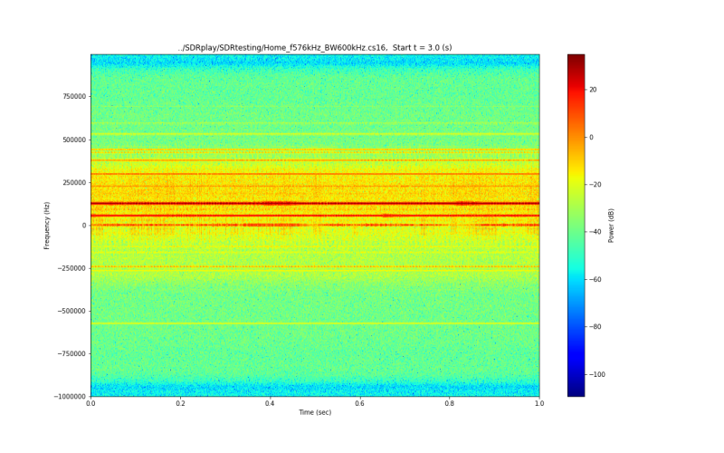

The following spectrogram was generated using data from the following command: playsdr -f 576000 -a1 -b 600 <output_filename>
This is Zero IF mode.
Home_f576kHz_BW600kHz.cs16_Spectrogram - resize.png (397.63 KiB) Viewed 10582 times
This plot makes sense i.e. 0Hz corresponds to 576 kHz and the other frequencies are in their expected places.

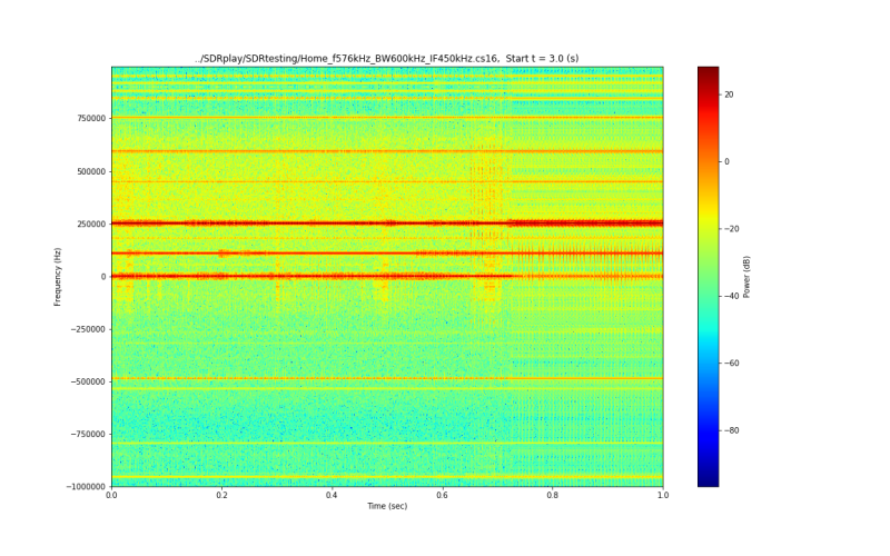

I then tried: playsdr -f 576000 -a1 -b 600 -i450 <output_filename>
I was hoping this would enable Low IF mode to reduce spurious signals.
This plot is not as is should be i.e. the frequency span of the signals has doubled.
Similar results are obtained, in each case, if a frequency of 702 kHz is selected.
Has the sample rate been automatically been reduced?
How can I check the SDR's internal settings?

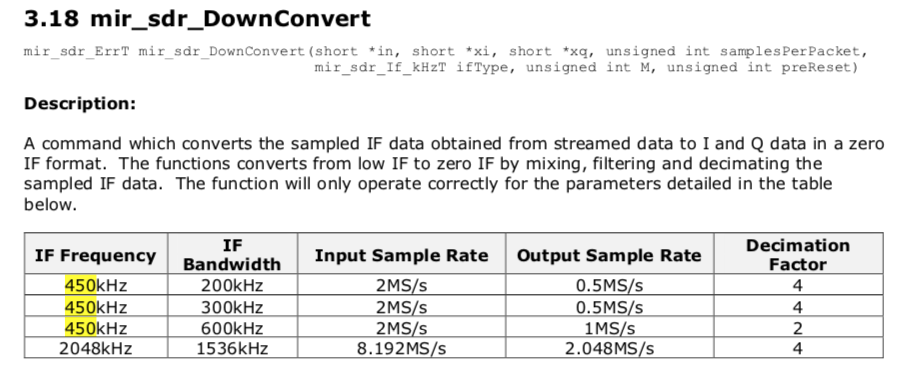

It seems that decimation is used.
In v2.11 of Software Defined Radio API is the following table:
SDR v2.11 API table.png (79.8 KiB) Viewed 10455 times
Thus, the output sample rate is changed.

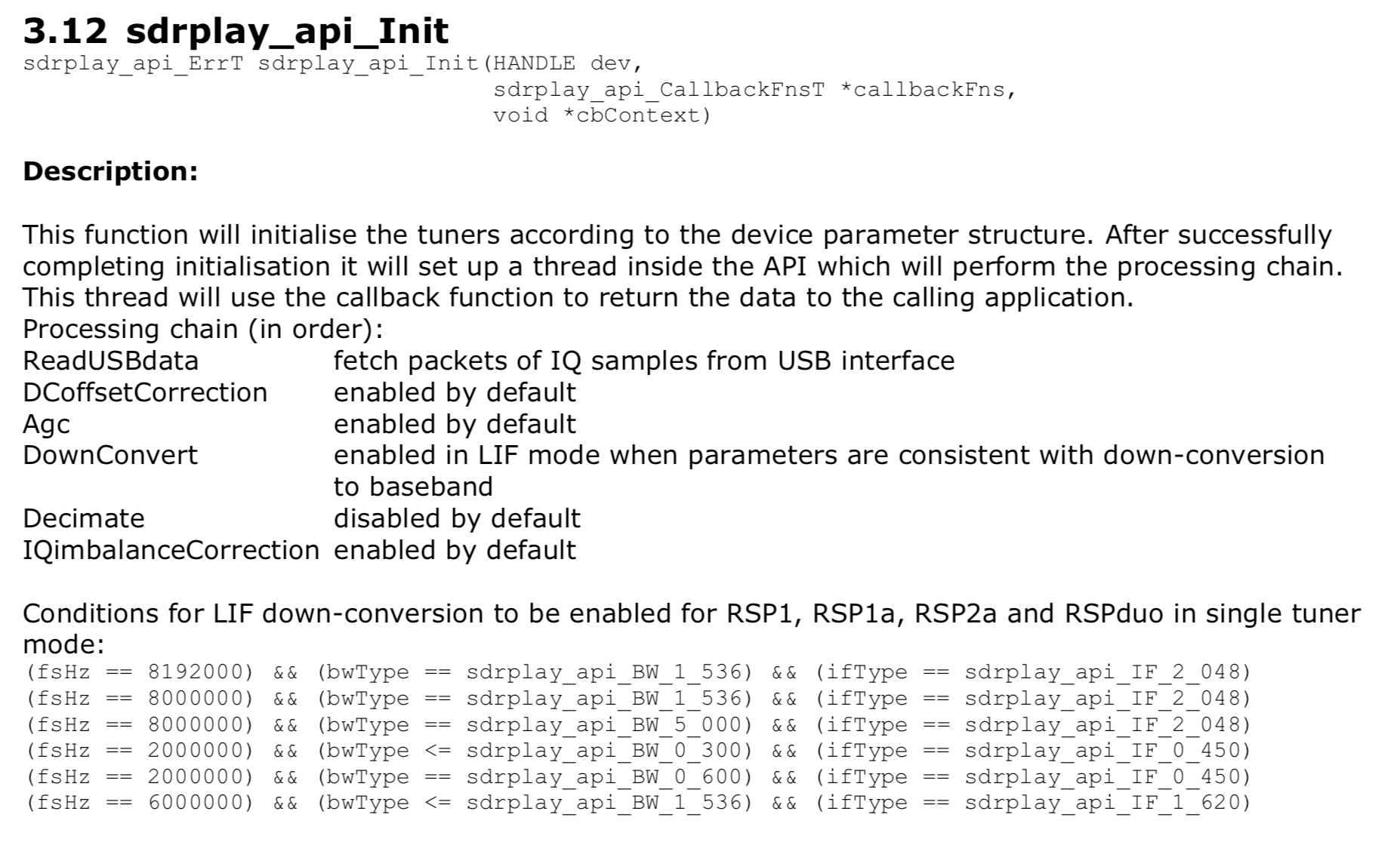

The following is from v3.01 of the API:
SDR v3.01 API table.png (321.85 KiB) Viewed 10535 times
A change to the sample rate is not mentioned. It even notes that Decimate is "disabled by default".
