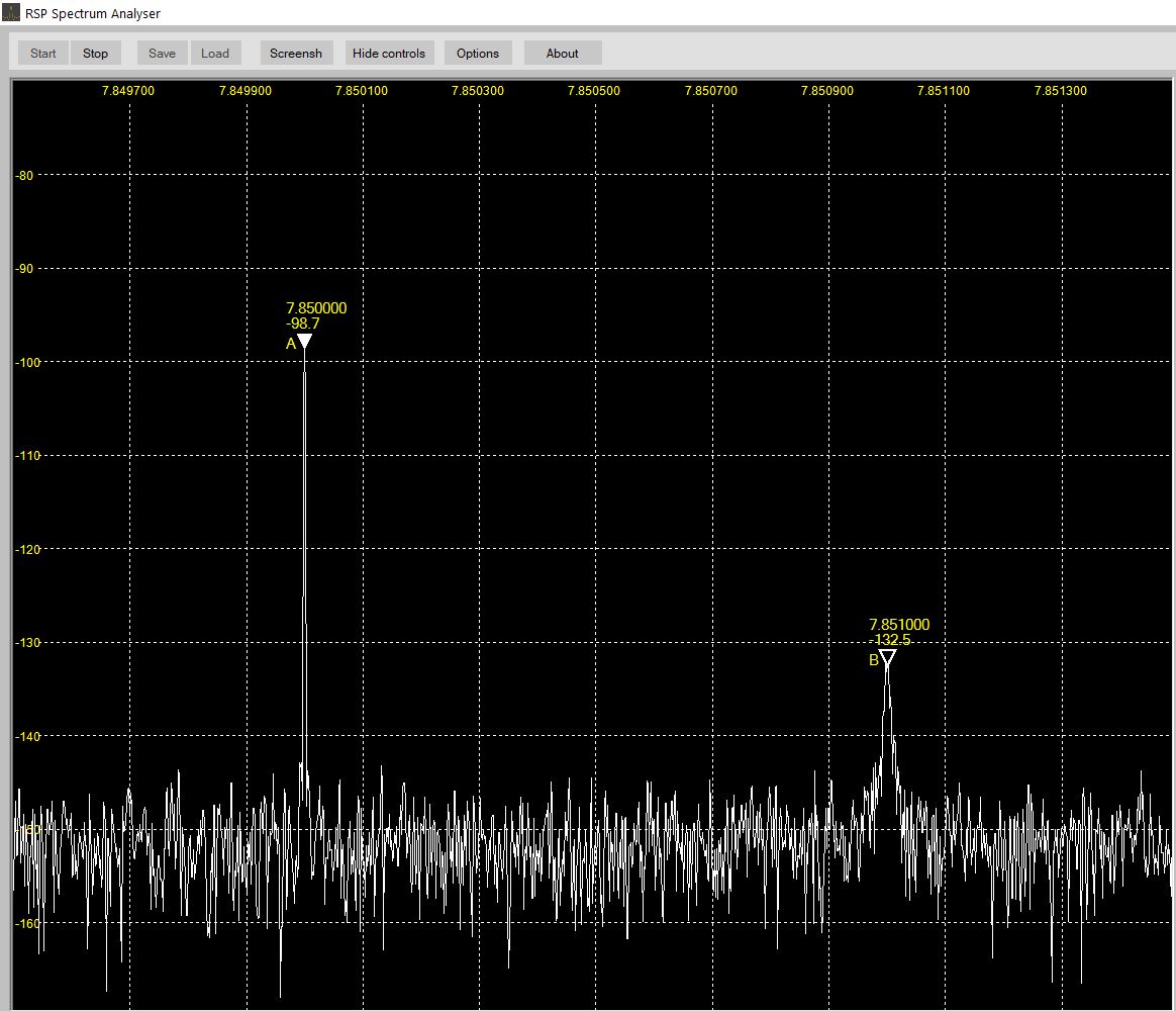

I use Windows Snip Tool for captures. Click on the 'attachments' tab - there will be a choice to 'add files'. 'Place inline' will appear after the file is uploaded. Make sure your blinking text 'cursor' is where you want it because that's where the image will be placed in the body of the message. Clicking 'Place Inline' inserts the image file into the message body.
They way I did it:
Set PPM first:
Span 1 kHz
Centre Frequency 7.850000 or 3.330000 - I used 7.85, 3.33 was nil heard
Trace select set to Raw
Sweeps: 2
NFFT: 524288
Place marker A at the carrier frequency in the spectrum analyzer's window
Slowly adjust PPM until the carrier is centered on the peak of CHU's carrier, it was -0.5 on my RSP2.
Tune the SA to CHU's 1 kHz tone by setting SA's Centre Freq to 7.851000. Place a 2nd marker B at 7.85100
In my case Marker A - Marker B was -0.001001 mHz (we've got a small error already!)

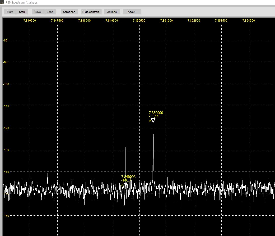

Now, set the center freq to 7.850500, span to 2 kHz (to see both markers). In my case marker B is now showing 7.850999. If you toggle between 2 khz span and 1 khz span you will 'lose' 1 Hz on each change at Marker B. You can readjust Marker A and B to the correct frequency easily at 2 kHz Span, it's next to impossible when the span is at 10 kHz.
2 khz span.JPG (165.32 KiB) Viewed 84274 times
Note how the marker frequencies change when span is changed.
10 khz span.JPG (154.63 KiB) Viewed 84274 times
Honestly, I don't think this program was designed with this use in mind. It works well for it's intended purpose, however.
