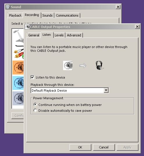

I run Windows 7 and had the same issue. In order to listen to the audio going into the virtual audio cable you have to set the checkmark labeled 'Listen to this Device' in the properties of your recording device:

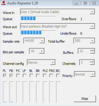

using Vista, i solved the probem by running one Audio repeater as follow :
73 Denis F6CRP

Thanks for the quick replies and you were spot on regarding the (Listen To this Device). I probably would never have found this check box as the audio preference appear to to be eveywhere. I will have to look at paying the subcription for VAC as you get an anoying android lady voice asking tyo upgrade avery 5 seconds.

Many thanks for the replies. You were correct it was the 'Listen to this Device' box that I needed to Check and now all works. I have also installed a new virtual order cable that is free. Note the VAC cabled also worked fine but you have to pay for it.
