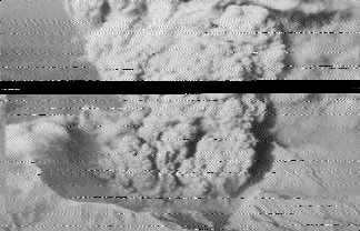

Each silence time correspond to a "[CRITICAL] ds_mir_sdr_ReadPacket() error: 1"
As example I attach an image received from VOA, with "hole" on audio reception
Can anyone confirm this problem?
