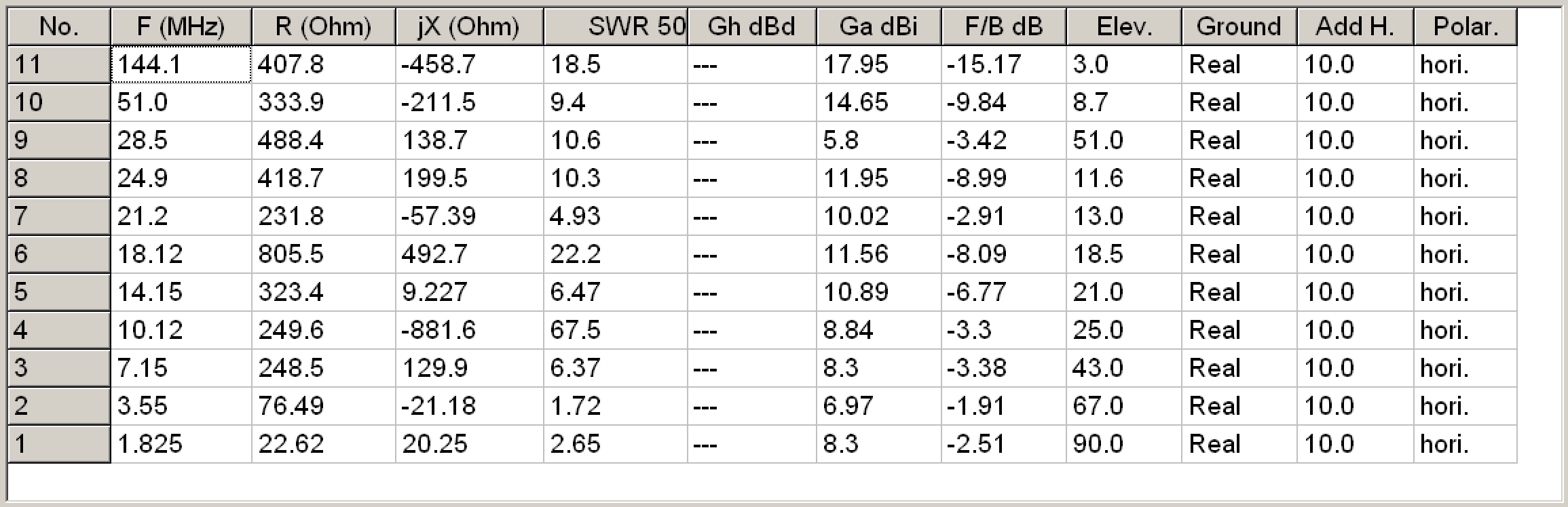

Here is a simple horizontal delta built from cheap Aluminium welding wire with a simple twisted pair feed. The pattern is very close to omnidirectional, the Elev column is the angle of radiation and the dBi gain column is very pleasing.
My mission in life is to convince the world that end fed wires are absolutely horrible and that anyone who has one who can find a second remote mounting point to create any shape or size of horizontal delta should build one immediately
