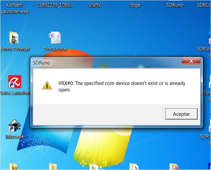

Problem is that I have not a SDRPlay, I have a RTL2832U device....When I open SDRUno the program does not recognize it.
Always appears this:

tomas112, please see this post. You need some additional SW. Hope this helps. Enjoy, John.

I have had the same error message. I managed to get rid of it by going into the settings on the RX screen of Sdruno. One of the tabs brings up receiver/transceiver. I unchecked the box at the bottom marked enable. Sdruno now works fine and I no longer get that error. I am using win 10 with the rsp.
Hope this helps
