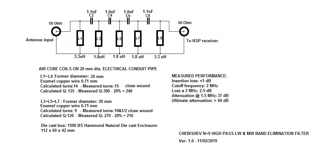

FILTER CHEBYSHEV HIGH PASS N=9 - 50/50 Ohm - UNBALANCED

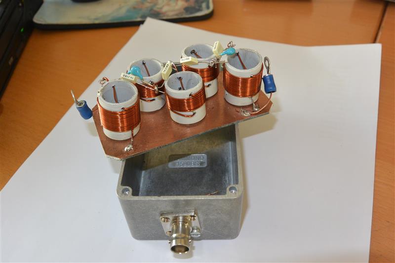

From prototype to finished filter
The filter is built on a one side PC board used as a soldering reference ground plane for minimising parasitic inductances. All components are assembled on this board prior to mounting inside the die cast enclosure. I was worried about parasitic coupling among the coils, due to close proximity, but filter attenuation @ 1.5 MHz is very similar to that of the original prototype (#6) so this problem did not materialise. Another worry was what would happen with closing the lid, but no detrimental IN/OUT coupling was detected.
Coil formers were made with 20 mm dia. PVC electrical conduit pipe and no detrimental effects on coil Q was detected. Once the filter is mounted inside the enclosure and tested, it is advisable to glue the base of each coil former to the PC board with bi-component epoxy resin.
Later today antenna attenuation of LW and MW band will be tested on the RSPduo and reported.
- Chebyshev N=9 HI PASS FILTER DATA.jpg (106.49 KiB) Viewed 106515 times
- DSC_1405.JPG (73.25 KiB) Viewed 106515 times
- DSC_1404.JPG (69.49 KiB) Viewed 106515 times

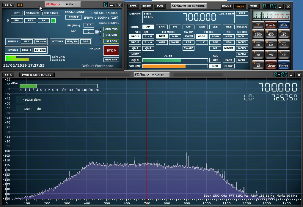

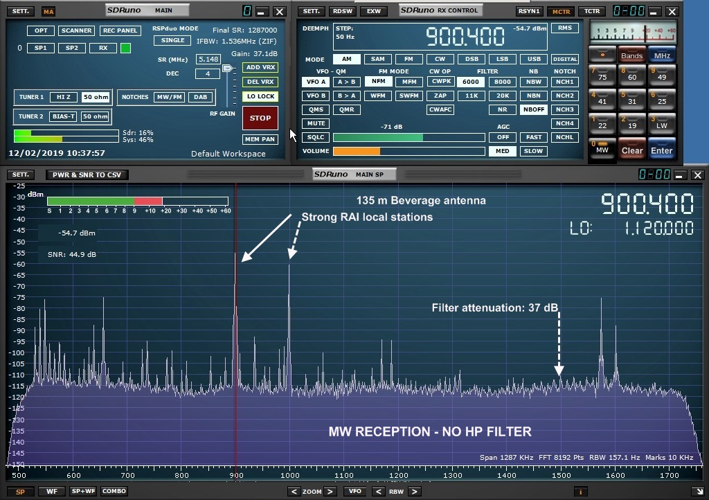

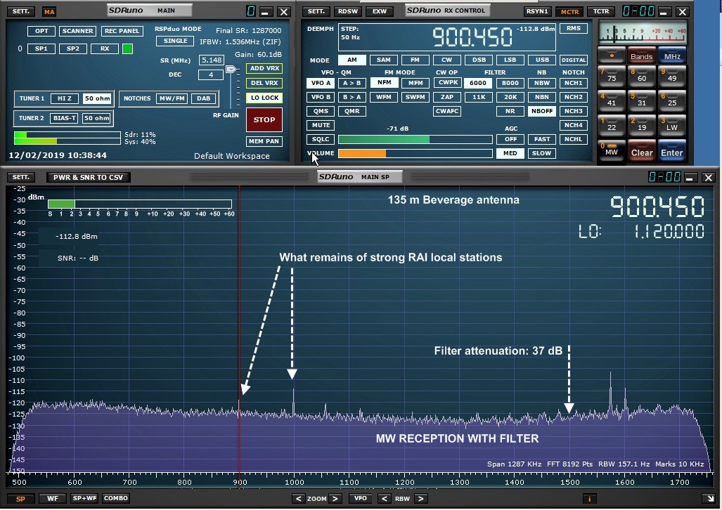

Practical results
Practical results
- HP filter in operation.JPG (75.92 KiB) Viewed 106510 times
- No HP Filter MW broadcast Band.jpg (264.92 KiB) Viewed 106511 times
- HP Filter in MW broadcast band.jpg (262.72 KiB) Viewed 106511 times

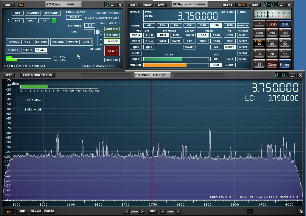

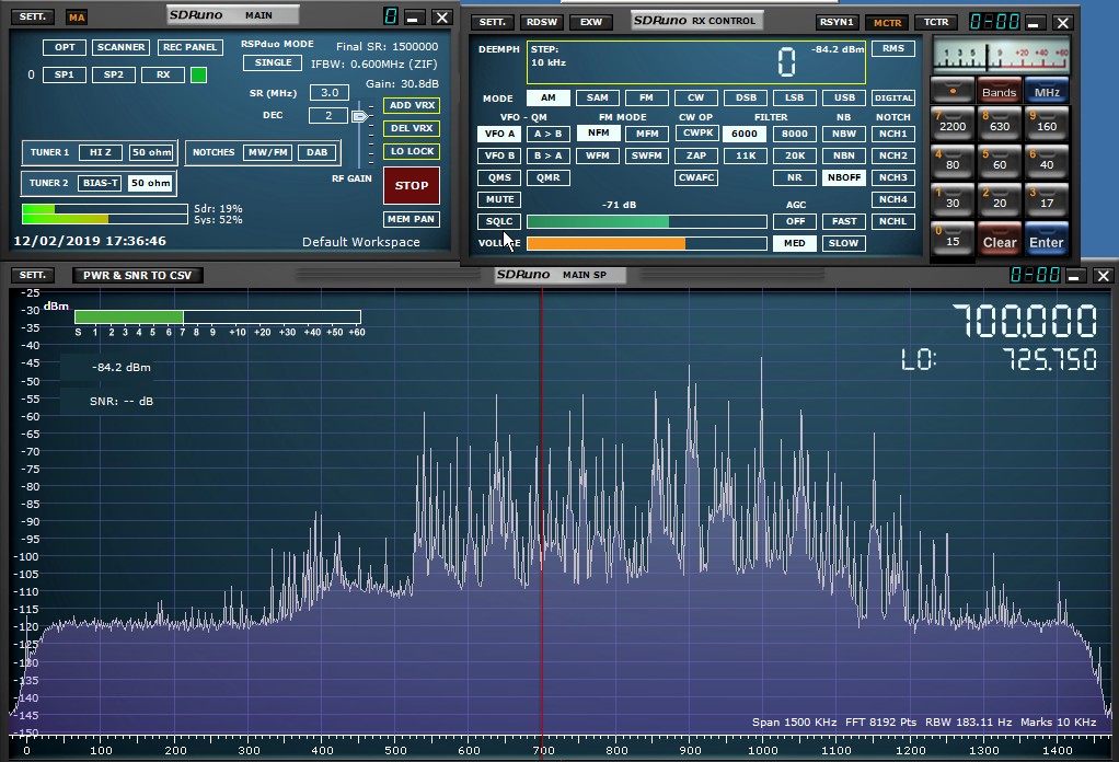

Re: HIGH PASS FILTER FOR OPTIMUM HF RECEPTION
Practical results
NOTE: For the measurements of previous post and of this one there is a 550 to 50 Ohm toroid transformer between Beverage antenna & filter's input.
Practical results
- While @ 3.6 MHz is business as usual....jpg (191.62 KiB) Viewed 106486 times
- Spectrum 0-1500 KHz - No HP filter.jpg (192.99 KiB) Viewed 106488 times
- Spectrum 0-1500 KHz with HP filter.jpg (179.73 KiB) Viewed 106488 times

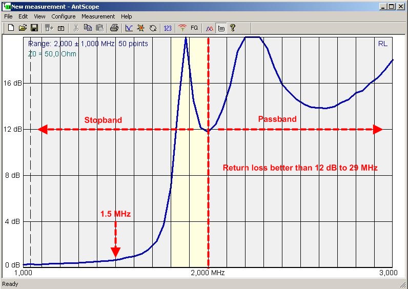

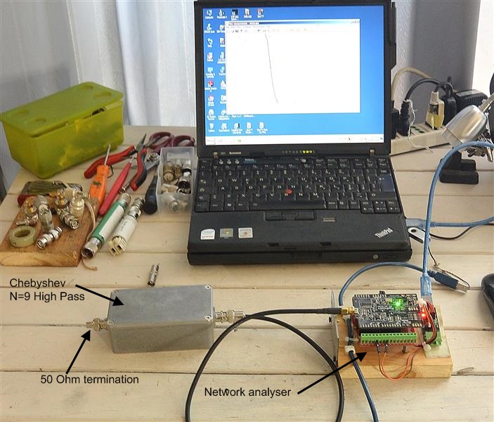

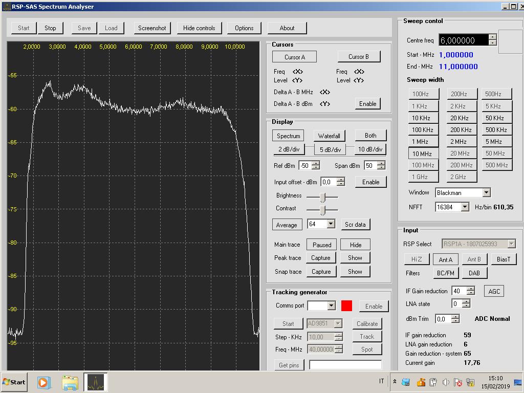

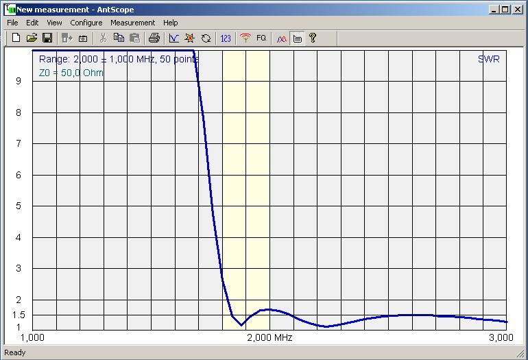

Filter performance near cutoff with Network Analyser- 1
- Measurement setup with AA30 Network Analyser
- Measurement setup.JPG (152.49 KiB) Viewed 106453 times
- Return loss near the 2 MHz cutoff frequency better than 12 dB
- HIGH PASS R.L. 1-3MHz.jpg (113.86 KiB) Viewed 106453 times
- SWR near the 2 MHz cutoff frequency 1.6 max.
- HIGH PASS SWR 1-3 MHz.jpg (65.35 KiB) Viewed 106453 times

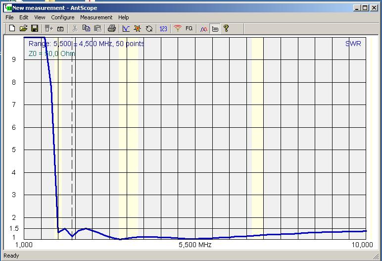

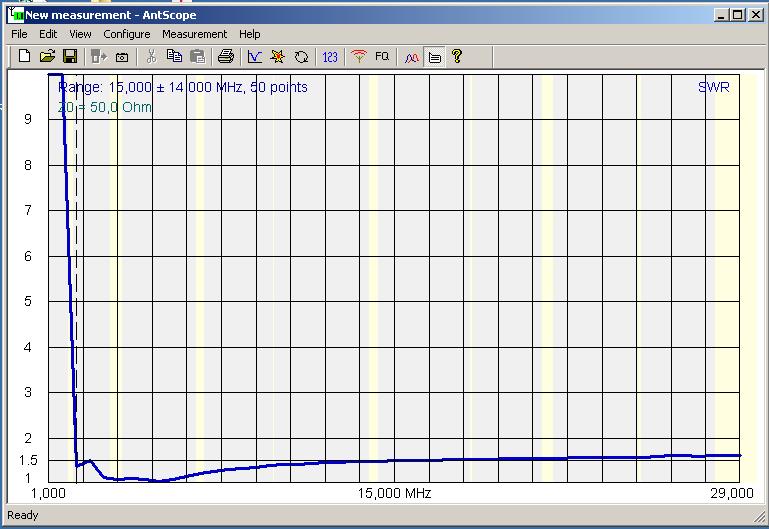

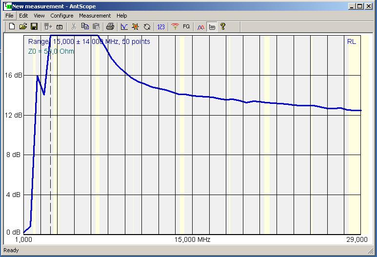

Filter performance 2 to 10 & 2 to 29 MHz with Network Analyser- 2
- HIGH PASS SWR 1-10 MHz.jpg (67.37 KiB) Viewed 106429 times
- HIGH PASS SWR 1-29 MHz.jpg (67.62 KiB) Viewed 106429 times
- HIGH PASS R.L. 1-29 MHz.jpg (64.44 KiB) Viewed 106429 times

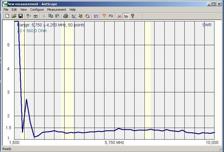

HIGH IMPEDANCE FILTER CHEBYSHEV N=9 / 0.1 dB RIPPLE / 560 to 560 OHM
Development and construction of this filter with a new layout & winding coil method went much quicker than anticipated and I am able to upload some measurements taken on the finished filter assembly, before mounting into the die cast box. Filter performs well and offers a SWR below 1.5 up to 15 MHz and a SWR below 3 up to 29 MHz. All details in the next posts.

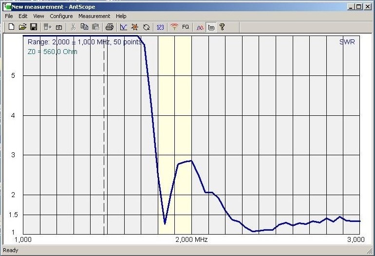

- High Pass Chebyshev N=9, r=0.1 dB, 560 to 560 Ohm - Bandpass plot to 6 MHz
- HIP HI Z Bandpass 6 MHz.jpg (149.65 KiB) Viewed 106330 times
- High Pass Chebyshev N=9, r=0.1 dB, 560 to 560 Ohm - SWR near cutoff frequency
- HP Hi Z 1K-3K SWR.jpg (102.69 KiB) Viewed 106330 times
- High Pass Chebyshev N=9, r=0.1 dB, 560 to 560 Ohm - SWR to 10 MHz
- HP HI Z 1.5K-10K.jpg (103.57 KiB) Viewed 106330 times
