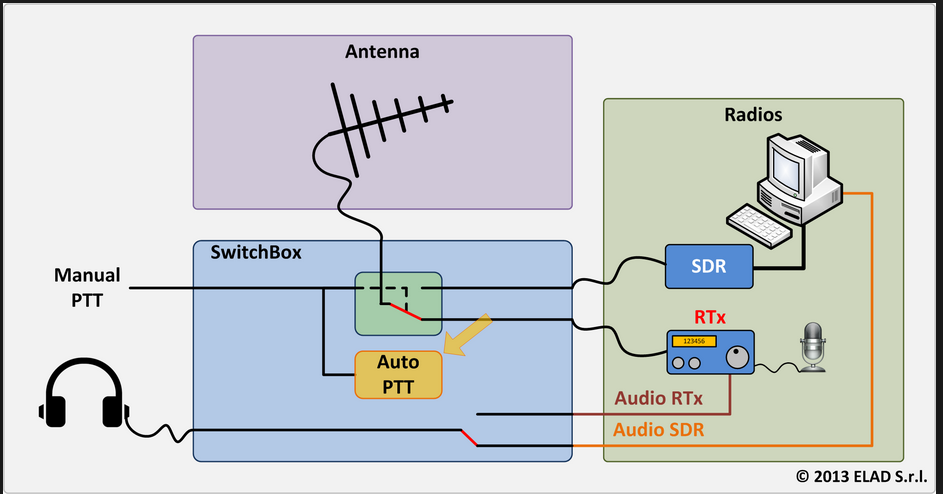

My HF Radio is Ten Tec Orion no receive out and no software command to mute audio ..I us a Switch Box made by Elad to control rf and audio and i use one antenna 80 Meter loop @ 60 ft it has worked well for me last 2 years i use a Elad sdr or Afedri and now messsing with RSP2 ..........

- xxxxxxxxxxxxxxxxxxxxxxxxxxxxxxxxxxxxxxxxxxxxxxxxx.PNG (101.12 KiB) Viewed 9668 times
