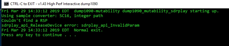

My issue is that 1090 works fine by itself in displaying aircraft at my location and I have verified by looing them up in flightaware but i cannot run dump 1090 when SDRUno is running (see attachment ) not sure when else to go to find answers.

Close SDRUno then try dump 1090. Only one application at a time can access an SDRPlay.

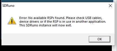

Thanks for your suggestion. Dump1090 will work as a standalone but only for 5 minutes. With SDRUno stopped (shutdown) and I start dump1090 here is the message I receive when starting up SDRUno again. when I shut down dump1090 I can again use SDRUno.
It was my understanding that SDRUno and dump1090 would work together as SDRUno is supplying the signals for dump 1090.
- No available rsp.jpg (31.19 KiB) Viewed 26804 times

Dump1090 is a standalone program and does not use SDRuno. Ay attempts to run both programs at the same time will not work unless you are using a RSPduo.

I think you slightly misunderstand me. What I was saying is that if you want to use dump1090 AND SDRuno at the same time, you will need either two RSPs or a RSPduo as each software package requires a single tuner.
You can use dump1090 on its own with ANY RSP.
