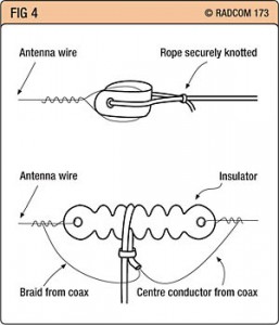

I have tried to build a coax dipole using RG58, each element being around 10meters. It should be similar to this design, using about 13-18m of rg8 as a feed line.Image

If your diplole construction includes a feeder cable arrangement such as that shown in the attachment to this message, then your basic connection as described by you is correct, conforming to SDRPlay's instructions (they do show an earth/ground connection to "shack" earth also).
