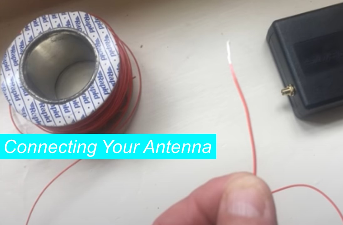

Connecting your antenna
The RSP1A RSPdx and RSPduo all have one or more SMA female antenna sockets. These sockets are designed to perform well over the entire frequency range whereas the other types of socket options provided on the RSPdx and RSPduo (BNC and wire terminal block respectively) are intended for use at frequencies below 200MHz (BNC) and 30MHz (wire terminal block)
The SMA socket therefore requires a standard SMA male plug (which has a centre pin). We discourage the use of all-in-one adapters to larger sockets (like the SO239) since these will put a strain on the socket. It is much better to use a length of coax to the next connector.
