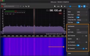

The Wide Band Noise Blanking controls can be found in the sidebar under “AGC/Squelch”:
The toggle is used to turn blanking on/off and the slider is used to adjust the threshold.

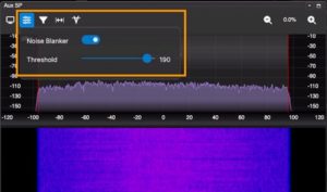

Since the Narrow Band Noise Blanker works on the Aux SP signal the controls are revealed by an icon at the top of the AuxSP window:
Again there is an on/off toggle and a threshold slider.

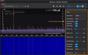

The Noise Reduction is turned on by a simple toggle in the Audio portion of the sidebar:
