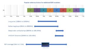

With any of the RSP family you have the possibility of receiving signals anywhere from 1kHz all the way up to 2GHz. That’s a lot of spectrum and no single antenna will give good performance over the entire frequency range. However it is possible to cover most of it with just 2 or 3 antennas.

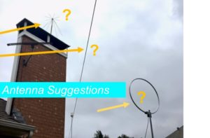

The picture above shows the four most popular choices of antenna for covering the bulk of the spectrum offered by wideband SDR receivers like the SDRplay RSP family. The “long wire” (more correctly named as the “random wire” antenna) and the whip antennas are the lowest cost options but have some limitations which is why the more expensive active magnetic loop and discone options have become popular. The key pros and cons are shown in the table below:
