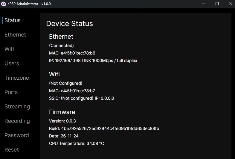

When you run the administrator tool , a panel will open up giving you access to a range of settings for the unit, such as the ability to enable the WiFi, set up user accounts for remote access and also change the administrator password.
The default administrator password is the device serial number which you will find on the box the device was delivered in, and also on the label on the underside of the unit. (Letters should be all upper case)

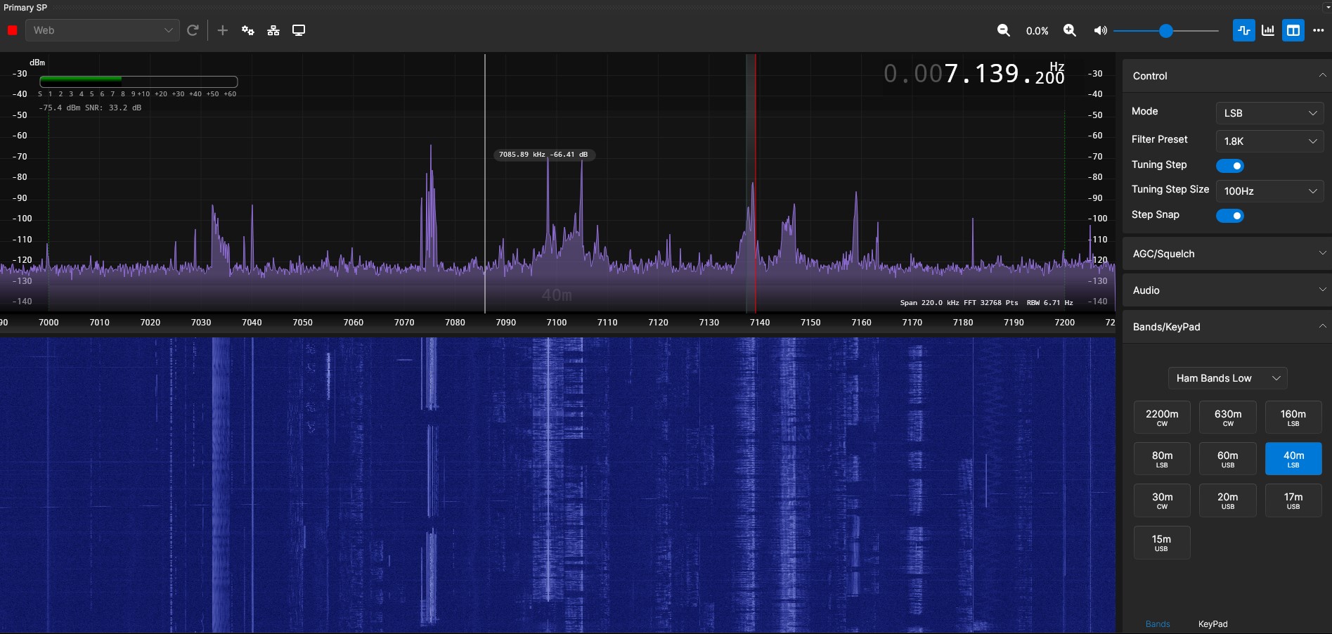

The web page version of SDRconnect is a simplified version of the main SDRconnect application. This is because we anticipate people using smaller screen Android or iOS devices such as tablets for remote web access and a simplified screen makes it easier to use on these smaller touch screen devices. If you have a laptop, you can still use the main version of SDRconnect to connect remotely to your unit.
All the main nRSP-ST functions should be present apart from direct recording to a NAS using the server. This feature is almost complete and will be added over the next few days.

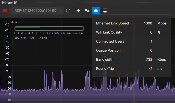

In SDRconnect itself, you will see a new button that is active when using the nRSP-ST. This gives information about the type and speed of the network connection between the nRSP-ST and your LAN. It will NOT provide diagnostics of the network connection between the LAN and the client device, but it will tell you whether your nRSP-ST is connected to your LAN via WiFi or ethernet and also what the speed of that link is. This might be a useful tool if someone has used an old 10/100 switch or cable to connect to their nRSP-ST.
